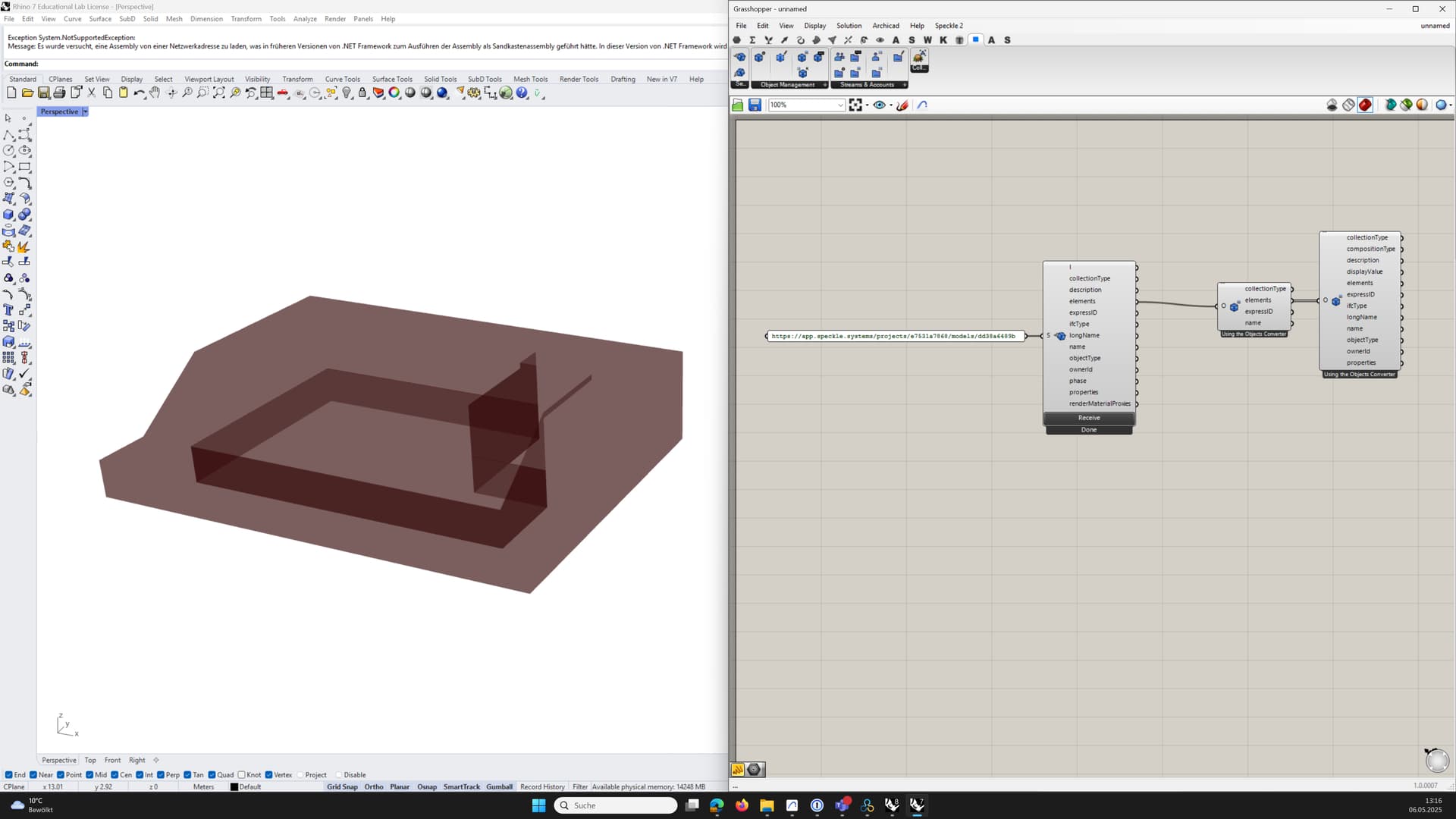

I tested to receive data with Rhino Grasshopper 7/8, it worked pretty good. But with one model I’ve a problem. It’s actually an Ifc from Archicad, which I dropped as an Ifc into the browser without the plugin. In only receive the terrain and not the walls and slabs.
bim-garage architectural ifc4 project base point.ifc - ifc-test | Speckle
any ideas?
reason for using an ifc → we’re modeling elements with mulitple layers like walls and slabs as one element, when we push directly from archicad, we can’t split the geometry, that’s the reason, why we do an ifc and drop it then to speckle.
