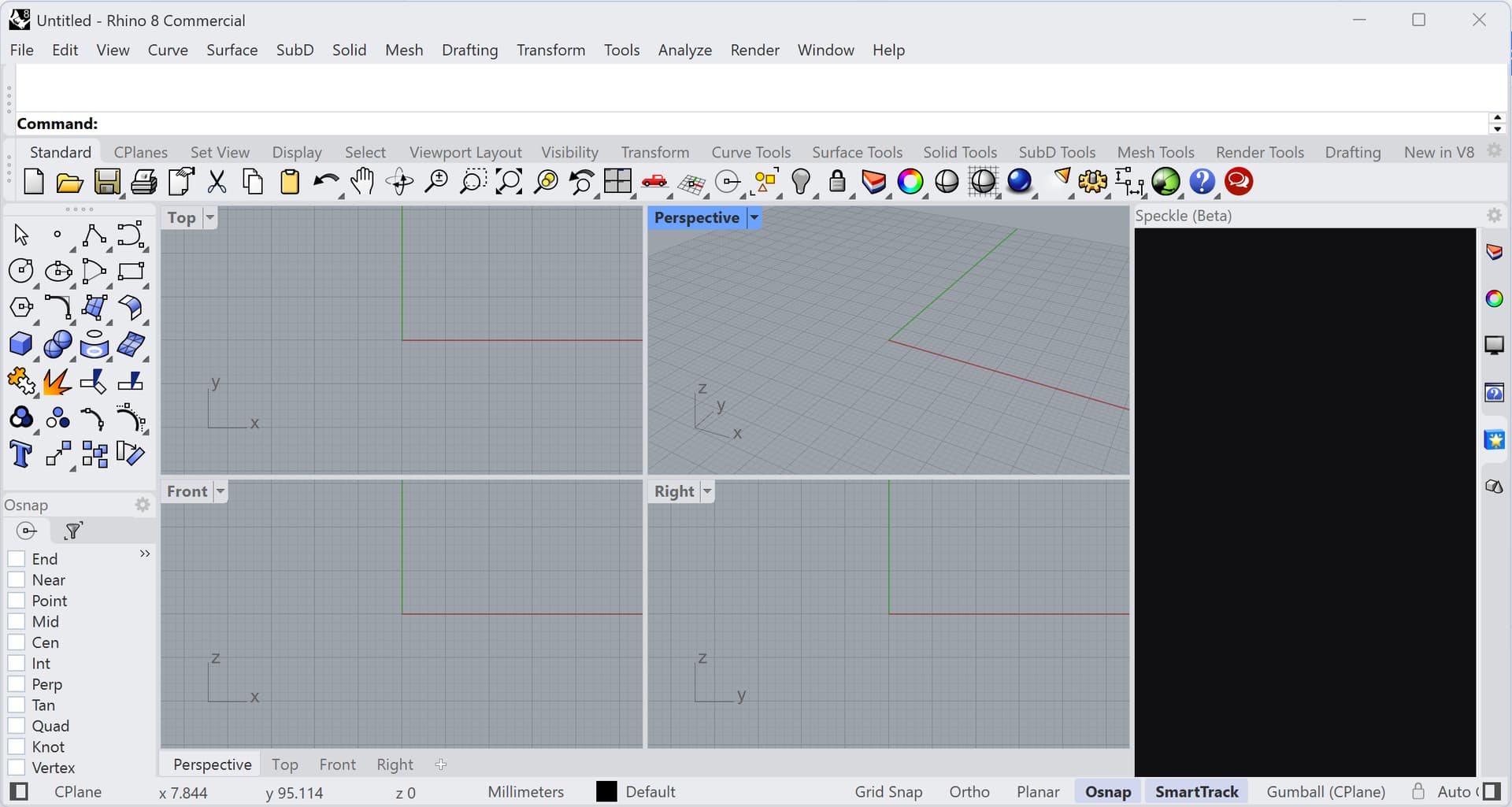

I have tried to install Parallels® Desktop for Mac and installed Rhino8 in there. But it is as if the Speckle Connector is showing up totally black. Is this a known issue? :slight_smile:

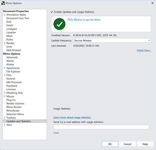

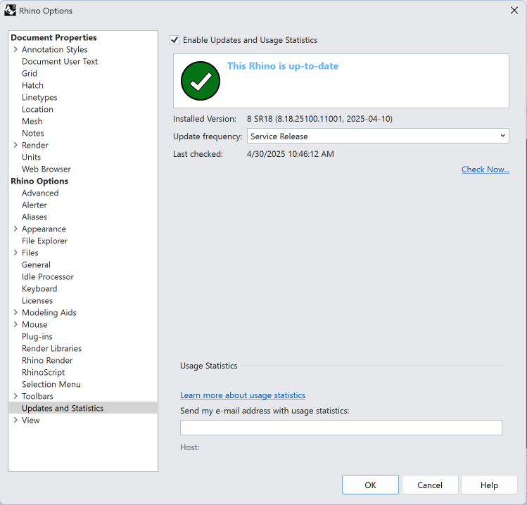

Ok, false alarm. @Johannes i just updated Rhino and restarted it. now it seems to work. Maybe try doing the same?
This is my Rhino version: Version 8 SR18
(8.18.25100.11001, 2025-04-10)
I have the same version as you, it looks like. Maybe I should try the .net runtime … Is that in Parallels I need to do that?

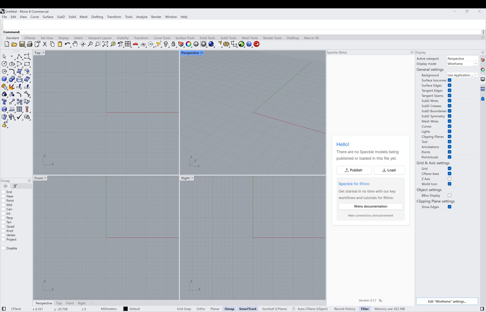

  • I ran the command: SetDotNetRuntime
  • Clicked the options until NETFramework appeared as an option.
  • Restarted Rhino
:white_check_mark: The black screen is gone, and I see the Speckle login screen.
Thanks for all the help :folded_hands:
