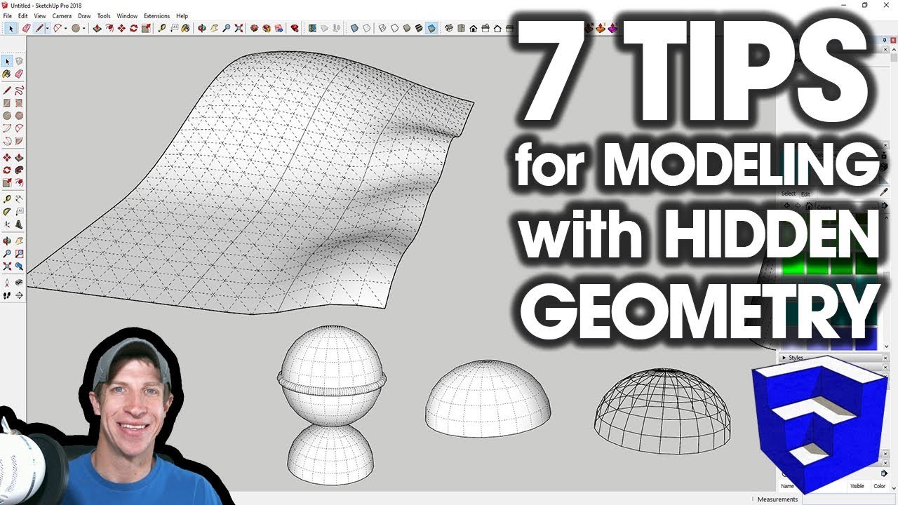

Hey @BrianTDA ,
Welcome to these parts. As @oguzhan said, you can unsoften/unsmooth those edges. Here’s a YouTube video that covers hidden geometry and how to work with them:
TLDR: Show hidden edges, then you’ll be able to extrude any face.
Thanks, for the help. I was able to find that setting and get the model in Sketchup to do what I wanted.
