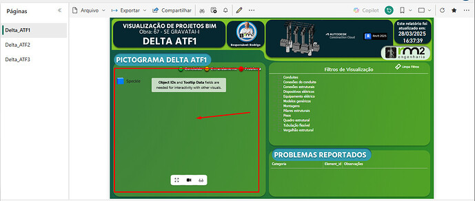

I’m ON again great. But i need help one more time, see:
This picture up, on power BI desktop
but…
This picture on Power BI On Line.
In Power BI Online, it is not updating to the old viewer version and insists on bringing the new version.
I have already deleted my browser cache but it still keeps bringing the new viewer and not the version sent from Power BI Desktop with the old viewer. Why?
Today, the issues show again on power BI On Line.
like image
how can i fixed this?

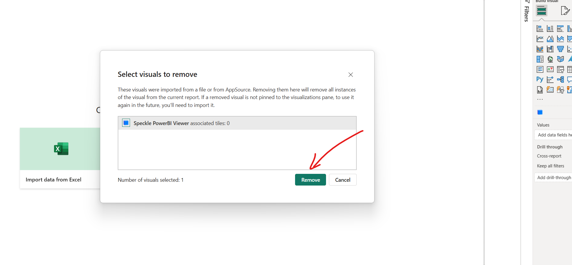

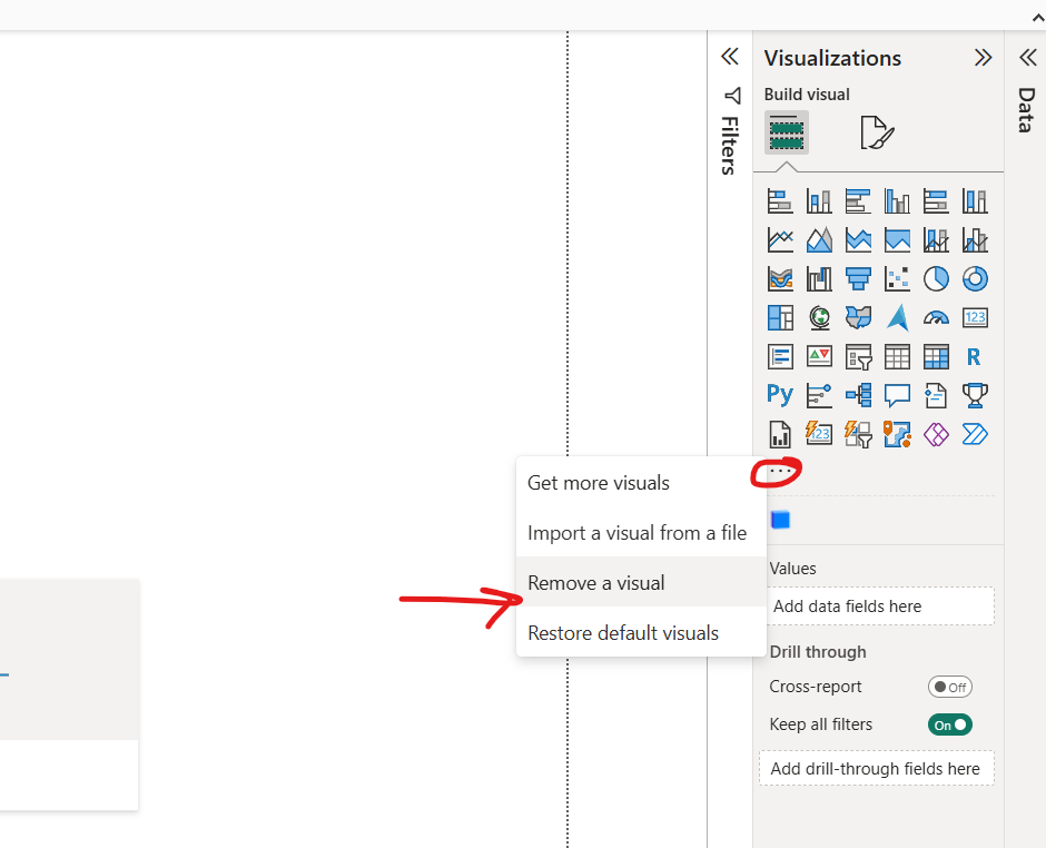

hey @digoms,
STEP 1: Remove the visual from your PowerBI
STEP 2: Unistall App
STEP 3: (If not installed already) Install PowerBI from Speckle Manager
STEP 4: Import V2 Visual
Tkx a lot Nikos
I’m ON again…perfect
