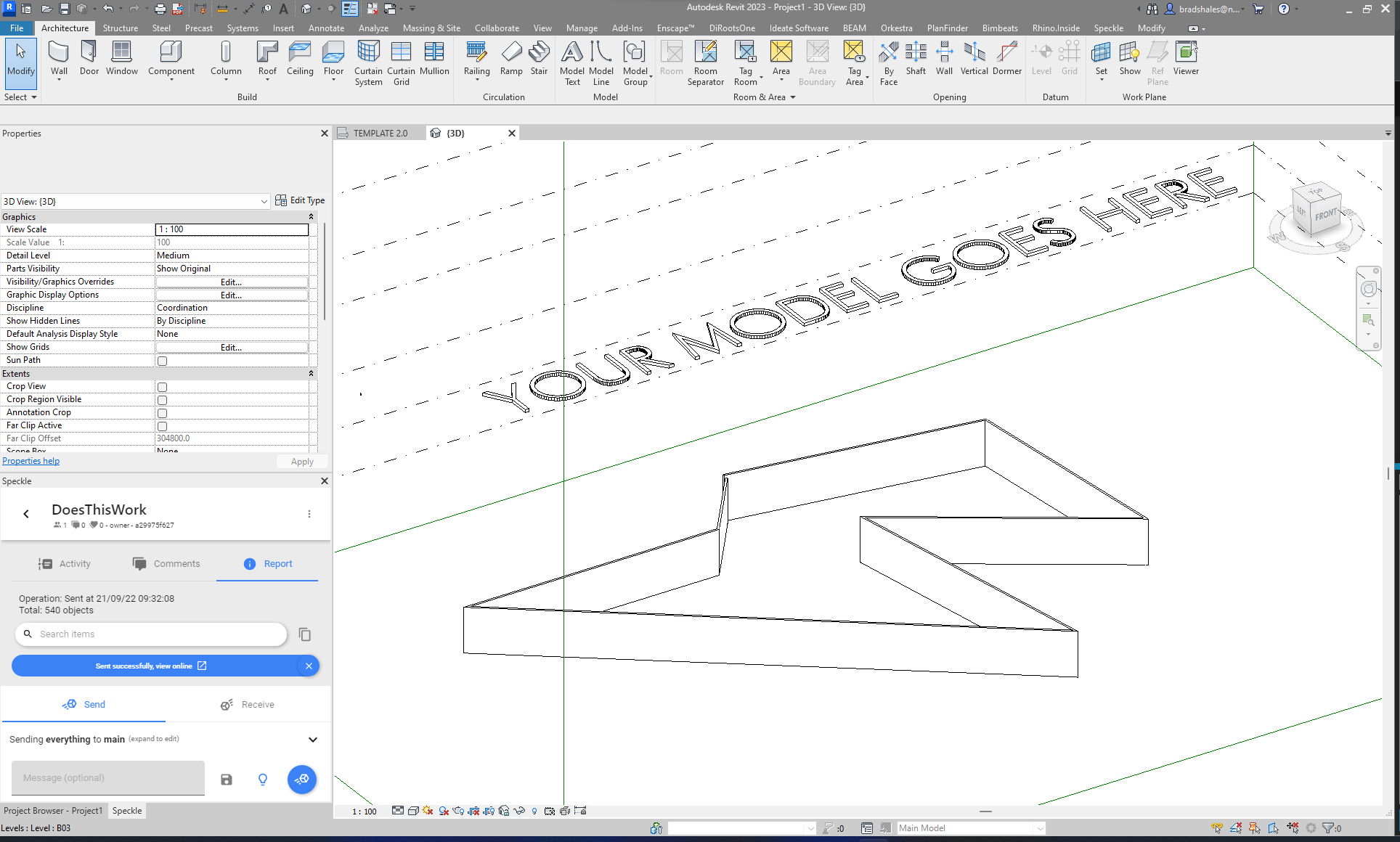

Hi @bradshales , thanks for the screenshot, can you please try updating the Rhino and Grasshopper connectors as well?

Hi guys… Sorry about this…
So this morning i removed the rhino and grasshopper connector…
and it works in the revits…
added the rhino connector… and…
this…
it broke
