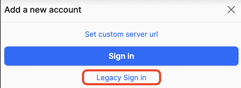

Hey @seanw,
Unfortunately Revit 2022 web UI framework is not friendly on this. I suggest you to use ‘Legacy Sign In’ option
Hey @seanw,
Since sdas stands for our desktop service, you should be good to authenticate with Legacy Sign In option
Let me know if it does not work for you

Is it expected that users need to log in with the “Legacy Sign-in” button in the connector when logging into a self-hosted server?
When starting a new server locally, it does not seem to include the sdui server app either. Is there a way to make this work?
Hi @nngaiup,
Self-hosted servers should use the legacy sign-in option right now. We will be aligning it, and you will need to update your server version to be able to log in with the default way.
