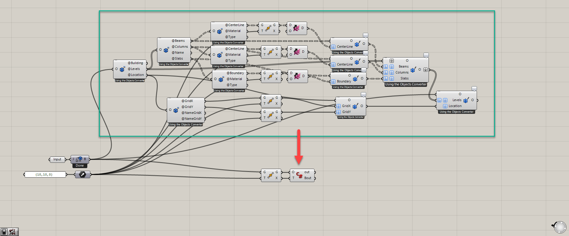

Probably I posted a wrong example, but the team is working with modularised grasshopper definitions that only take an SpeckleObject as input they do some operations and they spit out the SpeckleIObject updated.
So I would like to avoid to explode the object using ExpandSpeckleObject operate on all the geometries and re-compose the object when, I have an unique transformation to do.
This is what I am talking
The central part is where the transformation happen but to operate on that I have to find all the geometries and re-composing , this also mean that if the object change this definition has to adjust for the changes, instead if I travers the model and operating to all the geometry at once it will remove this definition and potential errors in adjusting the definition or re-composing object with the new changes.

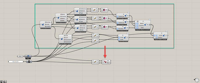

and this exactly the process is happanening into the GH C# node, data will be received, the component will traverse the object, converting to native, applying a transformation, converting back to Speckle and sent to the next step.
I am just bringing all the steps into one node instead of exploding everything as shown in the screenshot.

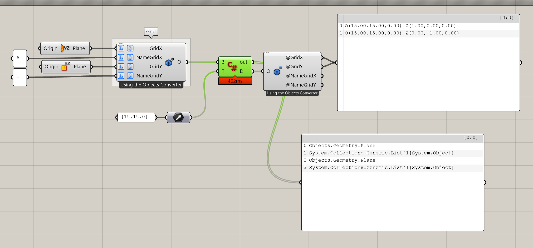

I had a quick look at your definition.
It seems that you are modifying the original input speckle object. I agree with @teocomi to always use ShallowCopy to ensure the gh cascade workflow.
If you print the type of member.Value:
Speckle.Core.Models.Base objBase = B as Speckle.Core.Models.Base;
    foreach (dynamic member in objBase.GetMembers().ToList())
      Print(member.Value.GetType().ToString());
      if(member.Value is IList)
        foreach(dynamic item in member.Value)
          if(!converter.CanConvertToNative(item as Speckle.Core.Models.Base)) continue;
          var element = converter.ConvertToNative(item);
          element.Transform(xform);
          var backToSpeckle = converter.ConvertToSpeckle(element);
          objBase[member.Key] = backToSpeckle;
…you see something is going wrong. You should have all Lists but you have Plane objects there.
The Origin of your Planes are not updated for 2 reasons
  1. because you are changing the original object
  2. because you are re-assigning to what was a list, the value of its last list item (plane).
(if you add a list with more than 1 value to the grids you will notice it!)

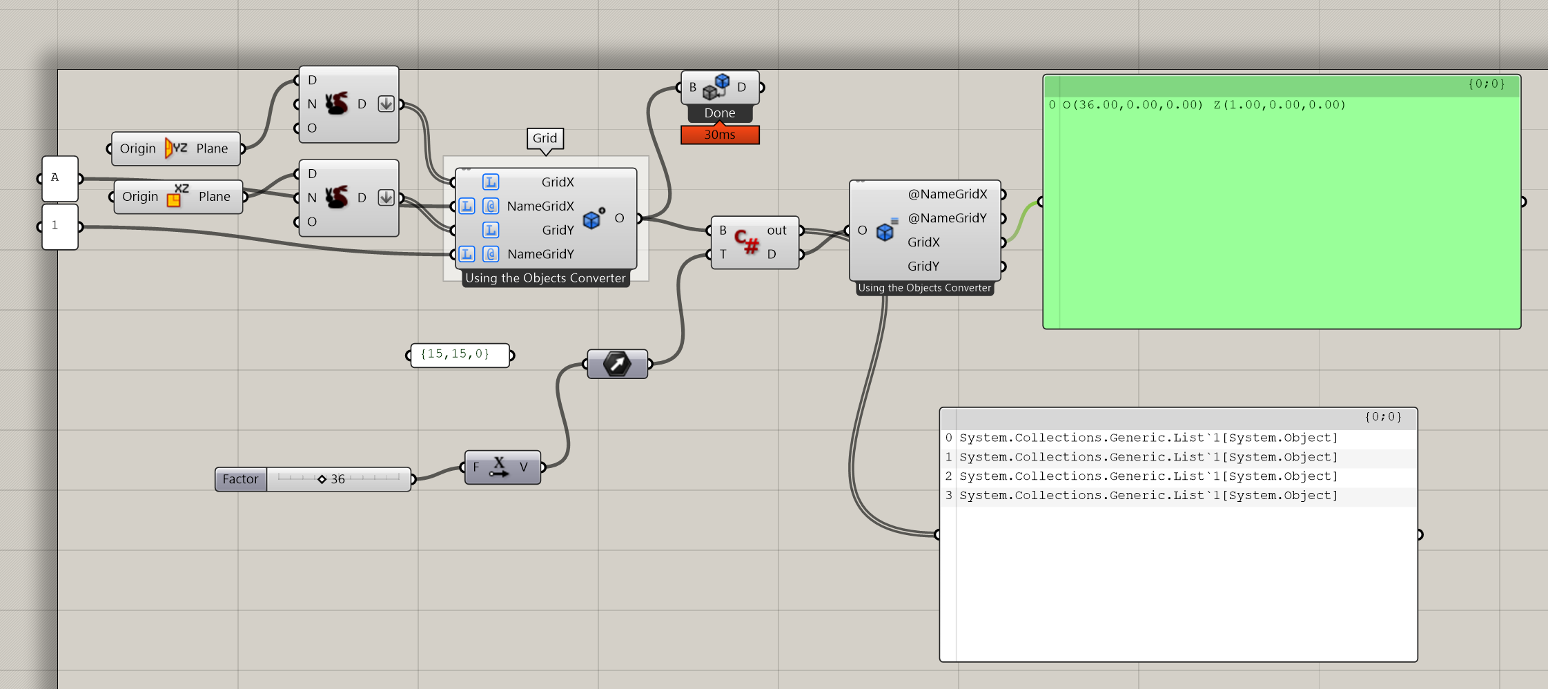

Sorry guyes, I didn’t update the conversation yesterday, but the problem was in one line of code, I wasn’t capturing the result of the recursion :rofl:
So now all the steps in the green box are captured into that single component.
Probably this is not necessary, because you know a better way to extract the geometries modified and update the Base, but this is what I was describing and trying to simplify.
