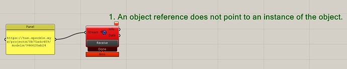

when trying to receive data in grasshopper, there is an error “An object reference does not point to an instance of the object.” reinstall did not help.

Hi @Ivan_Kapitonov
Please delete the receive component and add it back
Check for the first error, this is the cause of the problem.
e.g. when I tried this, the first error I got was that I was missing an account for https://tue.speckle.systems (which is correct :sweat_smile: behaviour)
It does seem that the receive component can error in a weird way that means subsequent attempts to receive give this null reference exception, which can be misleading.
I tried to delete and add the receive component, no change
It looks like the grasshopper components require an Account setup in Manager to receive, even for link sharable Projects.
Do you have an account added in Manager for https://tue.speckle.xyz?

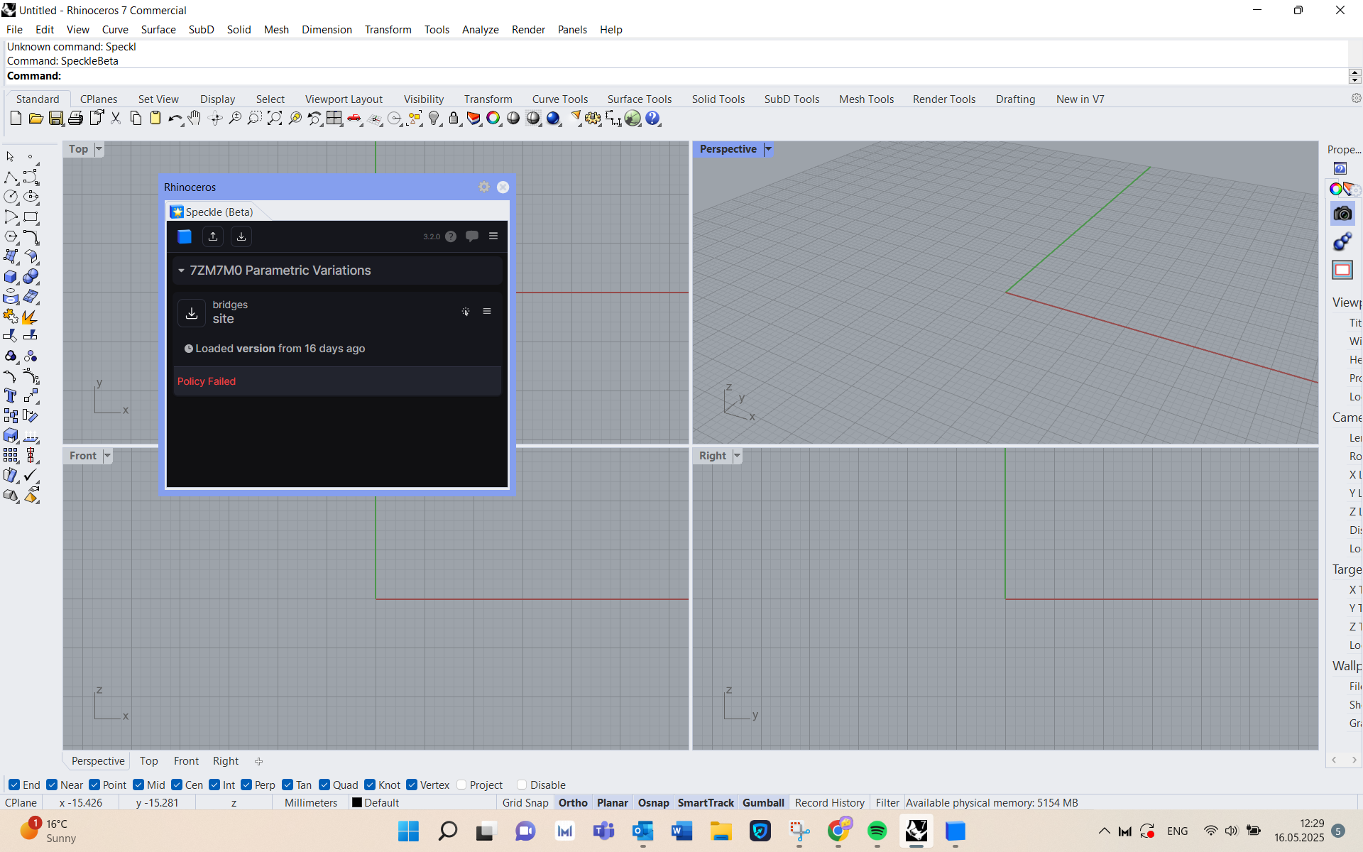

Trying to receive in Rhino, Failed

You can check your log files in %appdata%\Speckle\Logs\Rhino 8, you should find the full exception messages in the latest file.
Please send the file here, I can try and correlate with some server side logs.
