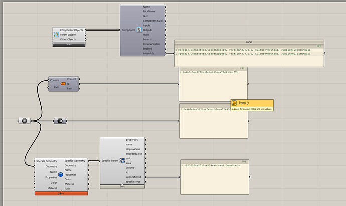

I still encounter the the issue where the applicationId is not persistent after the Speckle Object component. I am using version 3.9.2 as per the screenshot below.
Cheers,
Ray

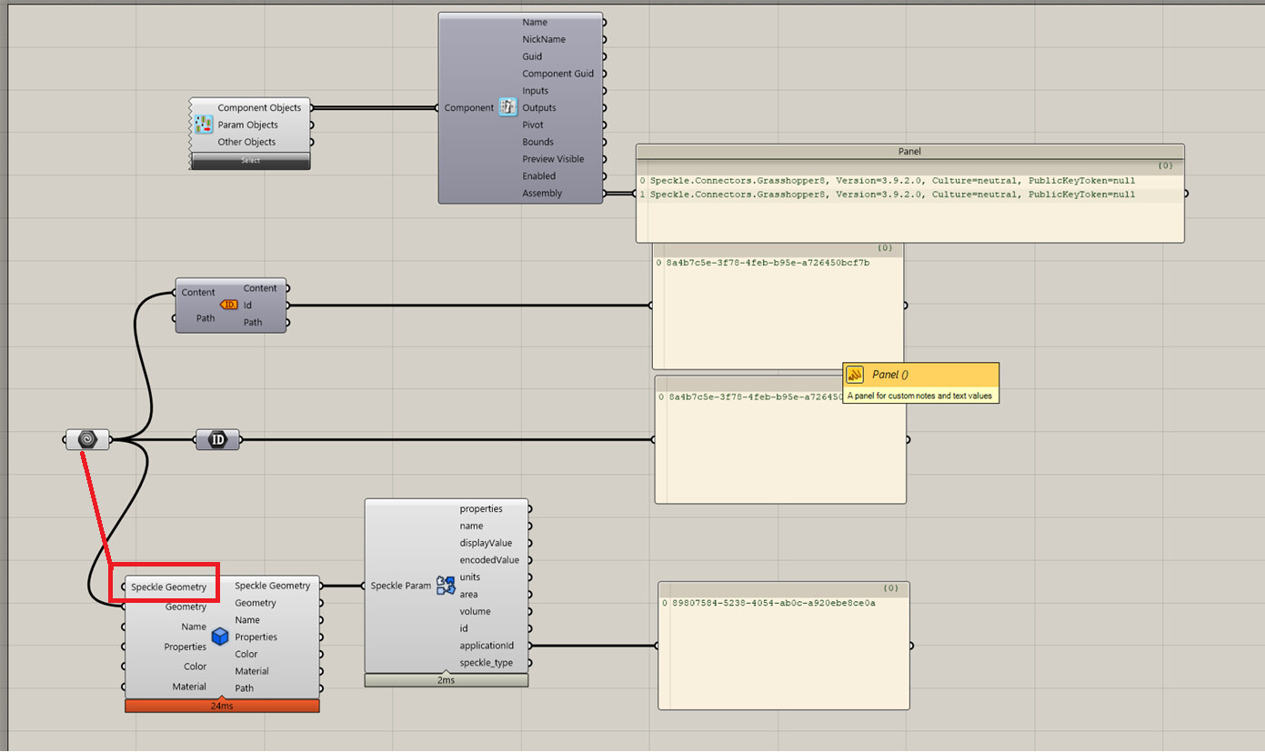

Ah, to preserve metadata on rhino objects, pass the object into the speckle geometry input rather than the geometry modifier:
This may not be very intuitive in the passthrough nodes, but only the first input will cast attributes and document-based properties: the second input only modifies the geometry. Objects - Speckle Docs

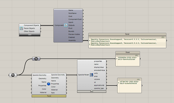

Hey @clrkng
I tried the way you mentioned, but i still get 2 different output of ID

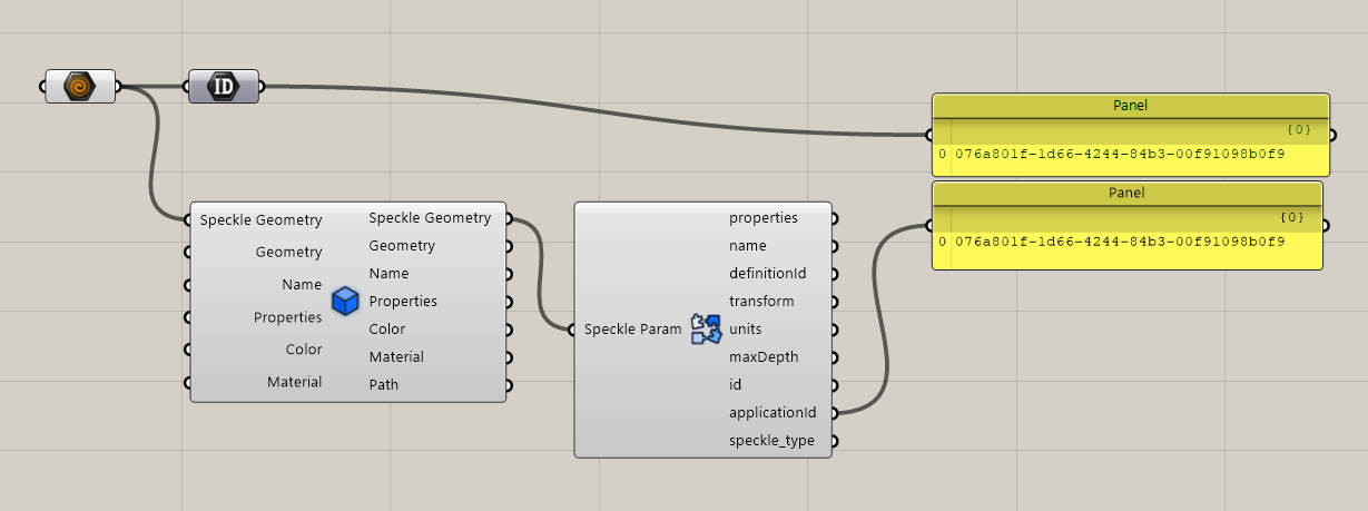

Hmm, I can’t replicate your issue:
Even though you have the latest version installed, could you try replacing your script nodes with fresh ones? They do not update automatically if you are working with a saved script

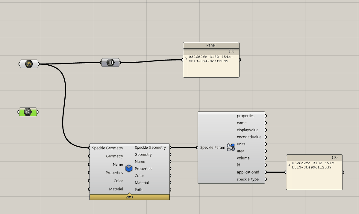

Hey @clrkng,
i found out the issue, when i reference using model object the application id and guid matched, but not with Geometry even tho it is a referenced object
id not consistent for non-model object
and once i connect the geometry to Model object, the guid and appid is consistent
