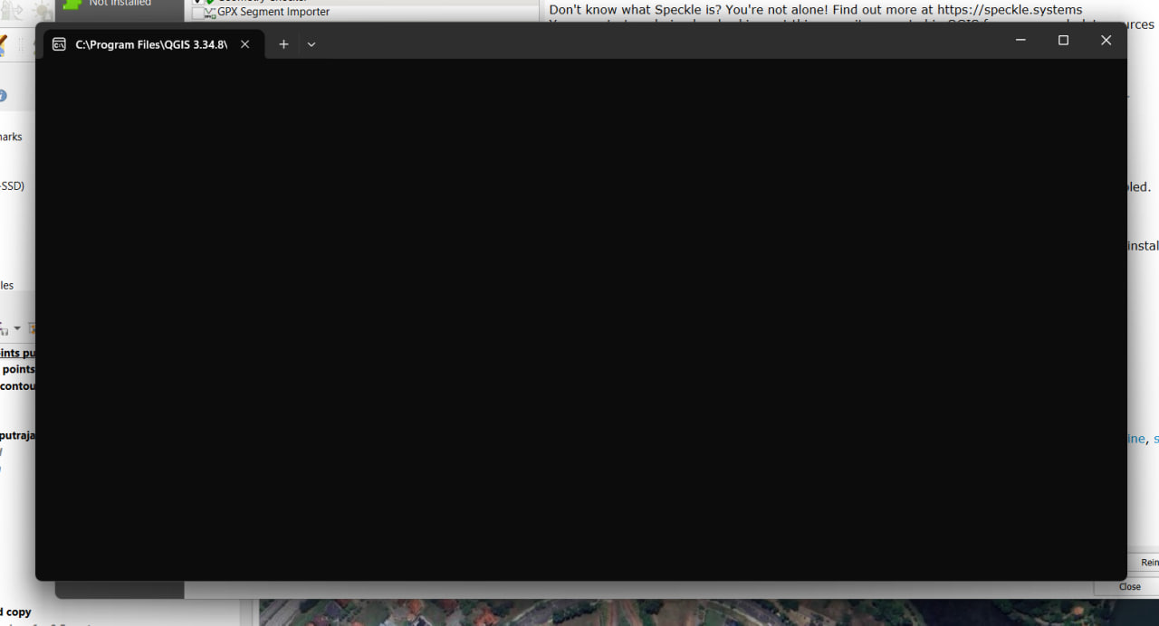

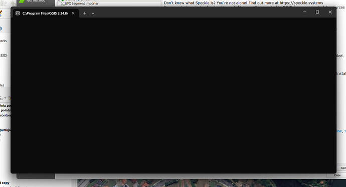

I have downloaded from Qgis plugin manager and install connector from speckle apps as well, tried on 3.38 and 3.34.8 also not able to use. I guess 3.34.3 compatible for the speckle, is it true?
I have 3.34.11 installed and i am able to use it. As a general rule of thumb, we try to support LTR versions of QGIS. @Kateryna are versions mentioned above supported?
Hi @aimi_khairina ! The latest version of Speckle plugin only works with 3.34.6 onwards. And as @gokermu mentioned, I would recommend to always use the latest LTR for QGIS, available here.
P.S. once you have the newer version of QGIS: the black screen you showed just takes a moment while the Python libraries are being installed.
