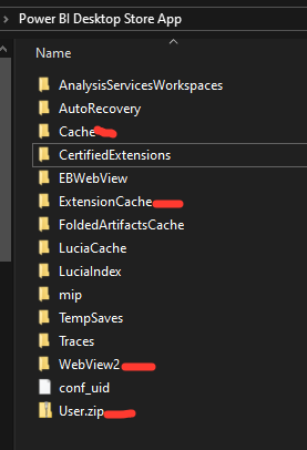

I’ve attached a screenshot of all folders I have in that folder and marked the ones I’ve already tried deleting. Is there anything else I should try? Thanks!
Hey @rvida ,
Can you delete everything in that folder and try loading again?
Eureka! It finally worked! I was able to login with the correct username and load the data from the speckle model. Thanks @gokermu !
