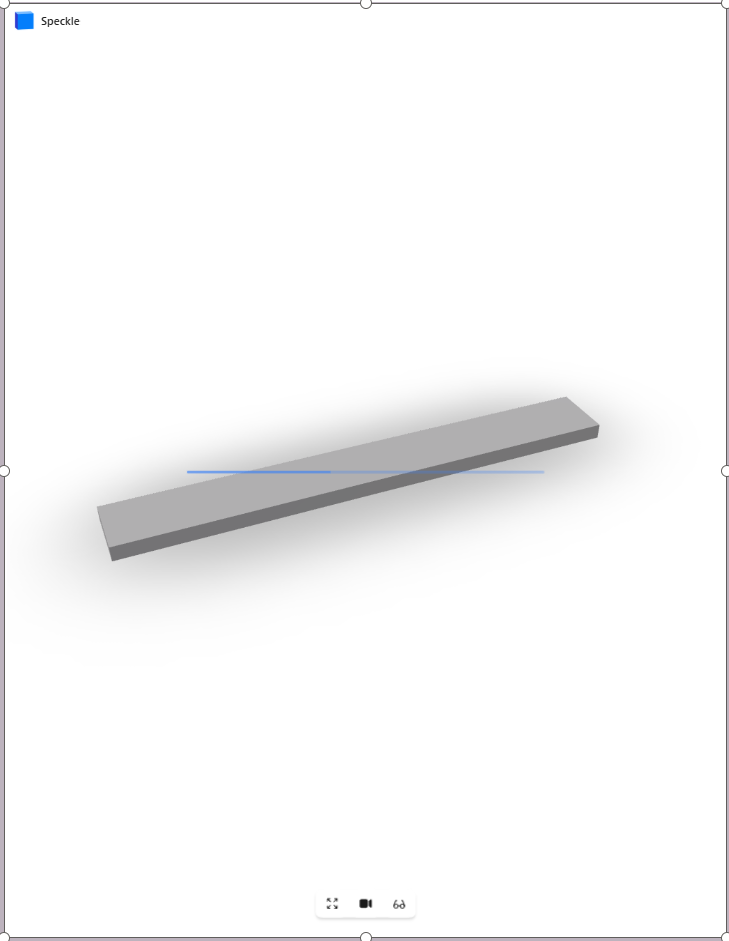

I am currently using the latest v3 connectors and visual to create a quantification dashboard in power bi.
My previous workflow (with the old v2 connectors) allowed me to visualize multiple models in one visual, and interact with slicers and tables quite nicely.
I appended the queries from each model in one query, and used that to populate my visual.
However, the new visual never loads my models. (I only see a plank :smiling_with_tear_spockle: )
I am aware that some limitation exists, regarding the support for federated models.
Is that the issue?
The way I found to bypass this is by using the old v2 visual, after adding manually the missing column Model URL for each stream.
Thought I’d let others know that it works (for now) in case someone needs it.
Hi @Anastasia,
Thanks for sharing your way with community!
Currently we do not support model federation with new powerbi connector, you are right. It is on our roadmap as first class standing feature.
