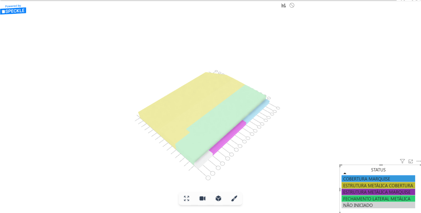

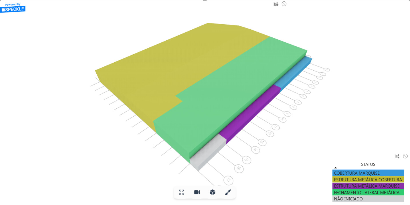

When using the PowerBI visual with a 3D model, very often we use colors to filter e relate to other data.

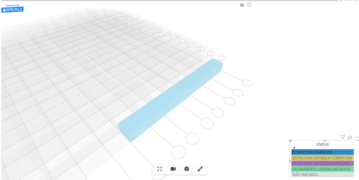

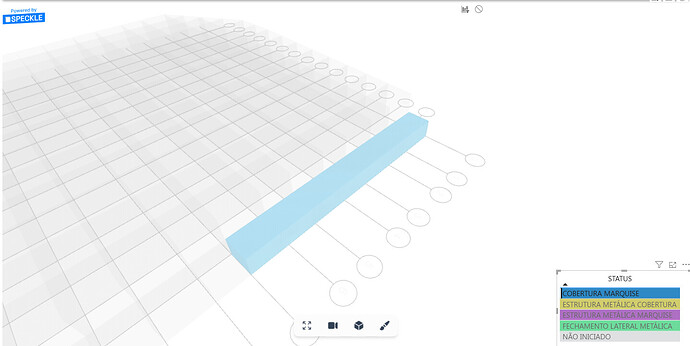

The issue I´m having is that when I first load the visual, it appears with very live colors, but whenever I use a filter segmentation, the colors applied seem to fade out, becoming “foggy” (see before and after images attached).
Is that common? If so, how can I fix it?
See how it is after reseting the filter:
Hey @jaribeirovargas ,
We have fixed this issue in our next-gen Power BI connector. It seems you are using legacy 3D Visual for Power BI. Get latest Power BI connector from here.

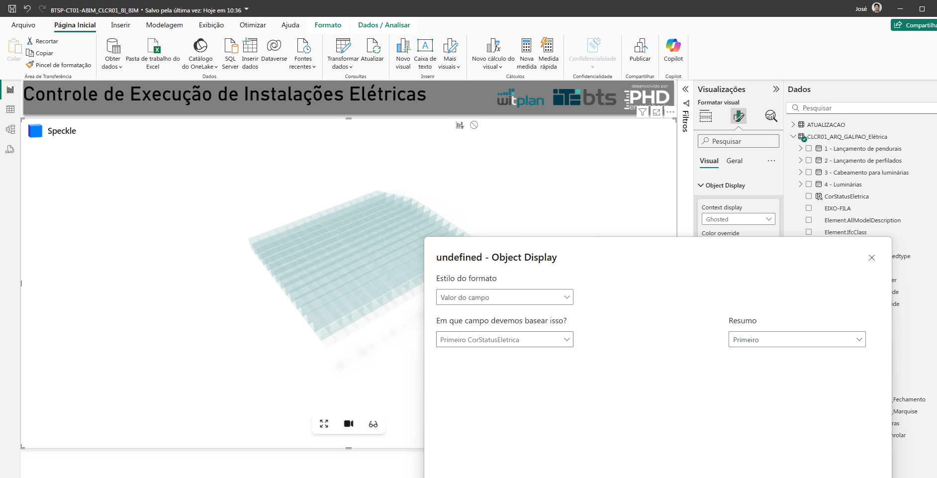

I´m having issue now with applying colors to the elements of the 3D visual. Have something changed regarding that?
See image. I attach a field value with hex colors and the visual does not update.
Yes, next-gen 3d visual does not support conditional formatting. We’re actively working on improving coloring logic in 3d visual.
