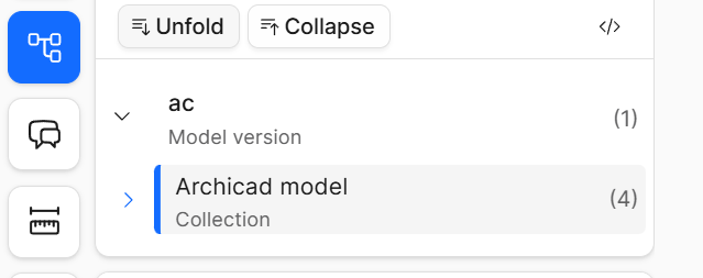

Can you use my example to show how it works?
Your model can be explored - the first branch under the model name is the version
Screenshot 2025-03-13 153243

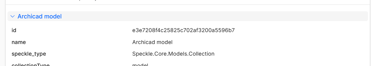

Inspecting this in Selection Info shows the ID
So with your project ID
https://app.speckle.systems/objects/b5c38a07cb/e3e7208f4c25825c702af3200a5596b7
