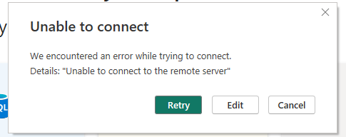

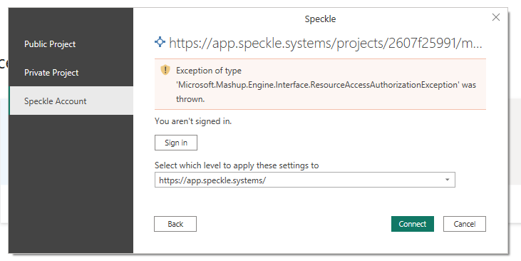

Hi Hi, I keep getting this same error although I followed the steps above [Clearing permissions] several times also using different workspace. Any further thoughts on how to fix it? Thank you in advance
This is the connector Iām using

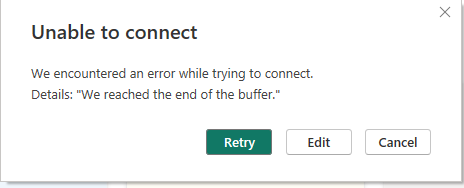

Hi @gokermu thanks for the quick reply. Yes I have now updated the connector to 3.2.0
Speckle 3.2.1 has been released. Let us know if it fixes your issue. @Maya
Thanks a lot @gokermu , just updated to 3.2.1. I get a different error. I think I saw this one on earlier threats

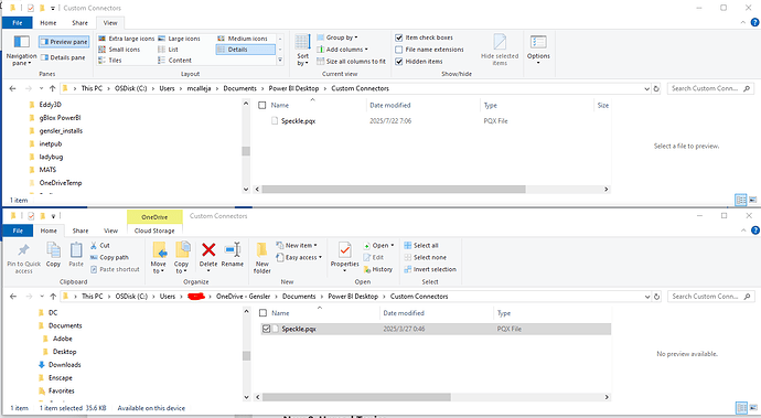

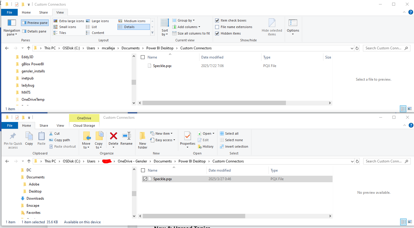

This seems like a legacy error. Can you share a screenshot of what you see in Documents/Power BI Desktop/Custom Connectors folder?
@gokermu Ah managed to make it work sorry my bad, I had it on two locations. 3.0.0 was installed from Software center on user permission. The 3.2.1 I had to download from speckle web and install it with admin permission on our org. Once I replaced it on user folder it works. Thanks a lot!
