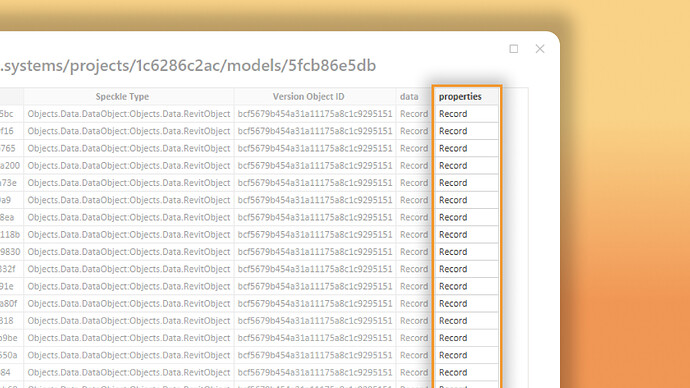

Auto Property Extraction
Now properties are automatically extracted and cleaned up without any extra configuration. This is currently only available for applications that support DataObjects.
- Supported applications: Revit, Archicad, Navisworks, Tekla, ETABS, Civil.
- Not supported applications: Rhino, SketchUp, AutoCAD.
