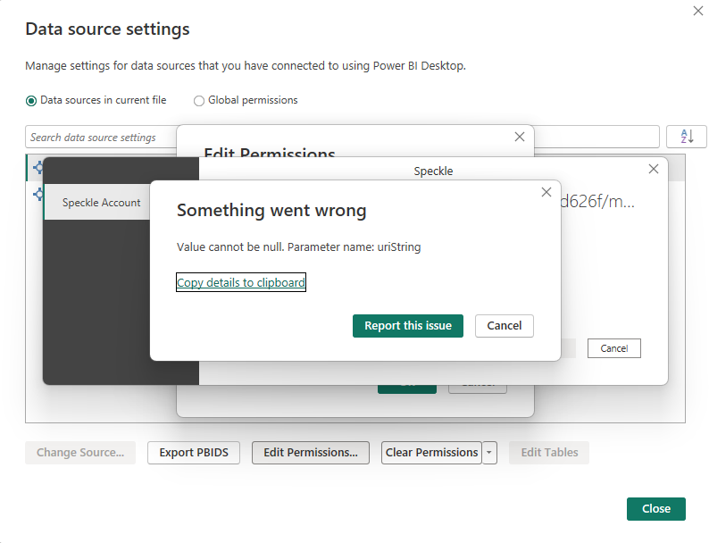

I have installed PBI connector 3.3.2 and I cannot connect to the models. The only connection method available is “Speckle Account”, which throws and error when I try to sign in.
Previously I was using 3.2.2 and I had 3 different connection methods, one of which was “Personal token”.
Do you have any ideas how to solve this error? This is my work computer.

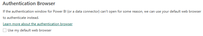

The problem is a mismatch between browsers. Please go to Options -> Security and uncheck the option for Use my default browser.
This should fix the issue.
It worked! Many thanks!
