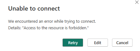

I am getting following error when trying to connect to the power bi model.
“Access to the resource is forbidden” I have recently updated my connectors to the latest generation and moved project to new workspace on the paid version. Project has access set to Public so not sure why I am to be able to connect ?
Hi @Maciej_Sochacki,
By any chance you are not an Editor in your workspace?
I am editor and admin of the workspace and owner of the project. :thinking:

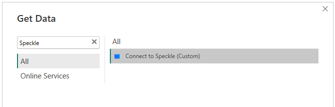

The connector below - I think that is the latest but it does not really give me an opportunity to sign in with credentials or anything just the error.
Hi Maciej,
Which Power BI version do you use? It usually happens in older Power BI versions. After updating, cleaning permissions using File > Options and Settings > Data Source Settings > Global Permissions > Clear Permission and signing in again might help.
Hi @Maciej_Sochacki ,
This is a browser related issue. You can get rid of the error by going to File > Options and settings > Options > Security and under “Authentication Browser”, uncheck “Use my default web browser”.
Morning @gokermu and @dogukan ,
Thank you both for prompt replies. Clearing old permissions has worked and I am able to connect :blue_square: !
Maciej
