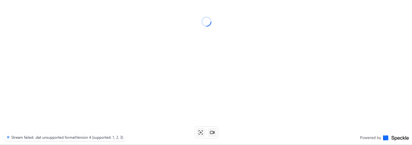

The Speckle 3D visual in Power BI fails to render a newly uploaded model (screenshot below). Data loads fine through Speckle.GetTables, and the model opens in the web viewer. Only the geometry in the visual fails.

Hi Speckle team,
Since October 1st, a new model version we uploaded fails to load in the Power BI visual with this message:
“Stream failed: .dat unsupported formatVersion 4 (supported: 1, 2, 3)”
What we checked:
  • Visual and data connector are both 2026.9.2, which is the latest release on GitHub. Reinstalling did not change anything.
  • The data loads normally into the table. Only the 3D geometry fails in the visual.
  • Older versions of the same model, uploaded before October 1st, still load fine in the same report.
  • The upload method did not change: drag and drop of a .nwd file on the web app (importer shows “Navisworks 0.1.0”). The same method worked on Sep 2, Sep 11 and Sep 18. The version uploaded on Oct 1 fails.
  • The new version opens correctly in the Speckle web viewer.
  • Another report in the same workspace, whose latest versions are from before Oct 1, still works.
Questions:
  1. What changed so that this version was generated in formatVersion 4?
  2. Is there a Power BI visual update planned to support it? Any expected date?
  3. In the meantime, is there a way to get new uploads in a format the current visual can read?
I can share project and version IDs in a private message if needed.
Hello @Patrick @joaoprimo
You will need to update to 2026.10.0
Cheers
