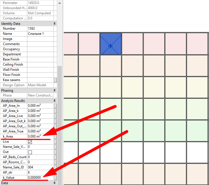

The issue i faced is sending ParameterUpdater to Revit’s shared parameter wich have Area/Number Type of data. I have made some calculations based on Room’s area and then tried to send new values to Revit, but they didn’t get the updates.
Below are some screenshots of my case:
Above you can see that after i recieve stream from speckle these parameters wewrent updated. I guess that that may be caused by wrong units setup, but I’m not sure… I saw in documentation that we have to specify m/mm/cm/inch or none. but What type of units should we choose for Area and Number parameter type? :slight_smile:
