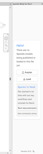

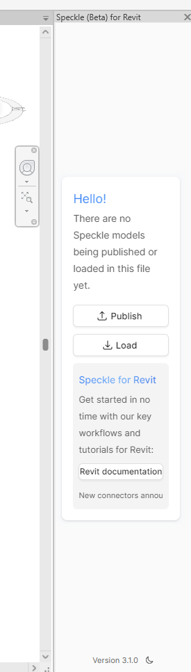

To test things out, I started a new project, verified I have the 3.1.0 Revit Connector, I’m trying to publish without success. I am looking for tutorials on new version, but can’t find them.
To test it out, I opened the previous revit model, and tried publishing it to another Speckle ‘project’ and it’s not working either.
