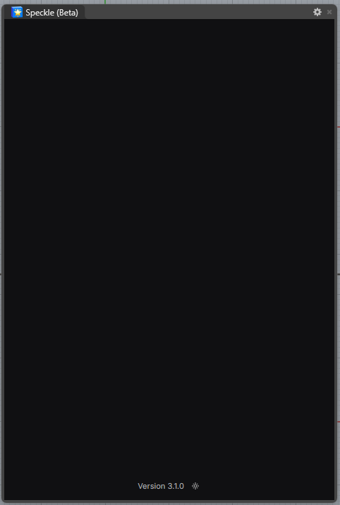

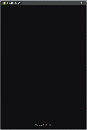

I just installed the next-gen connectors to test it out, and its just blank except the dark/light mode and version at the bottom (the dark/light toggle works) . This was on 2 different machines in Rhino. We even tried installing an older version, and we did get the popup saying there was a newer version. Any ideas on how to fix?
Not sure if it matters, but here is some info that may be relevant:
  1. I have 2.21.5 connectors installed as well and they work.
  2. I have the speckle manager installed and am logged into my companies speckle server
  3. Our server is running 2.18.5.
  4. Our server is deployed internally only, so not using https, eg: http://speckle.mycompany.com
Let me know if there is anything else that may help troubleshoot.

I had IT update the server to 2.23.15, and they are still blank…(FYI, the ā€˜old’ connectors are working properly with the new server)
Also have IT looking into adding the cert to our server so it can be ā€˜https’. You think this could be causing the issue? or the fact that its deployed only on our environment and not accessible via the web could be causing this behavior?
