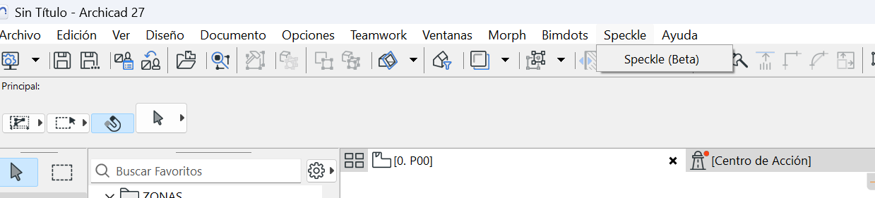

If the v3 Archicad connector is installed you should see a new “Speckle” item in the menu bar like this:

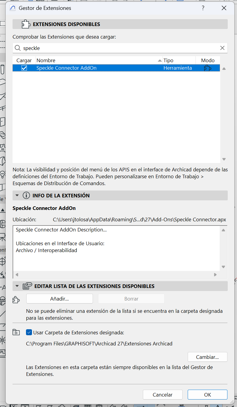

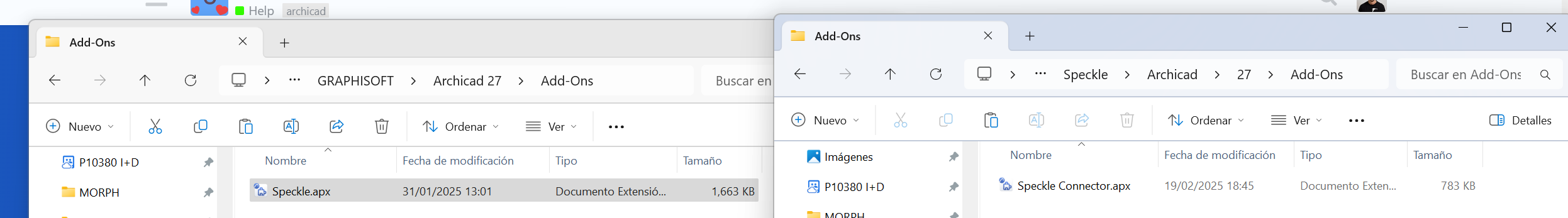

@gokermu I think you found part of the problem because the link to the Speckle add-on in the Archicad add-on manager is different to the one you sent me, and when comparing both folders in my local browser I can see that they’re different files.
This is the screenshot of the Add-on manager:
I bet that the file with the bigger size is the .apx with the next-gen connector so I’ll try copying it over there and I’ll let you know if it works!
That’s it!! Here it is
I had to paste the apx of the directory you showed me into the directory that my manager was telling me, changed the name to the one that the addon was trying to read and when I restarted Archicad there was my beloved Speckle tab! Thanks for the help!
