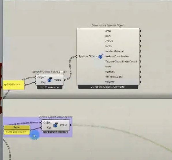

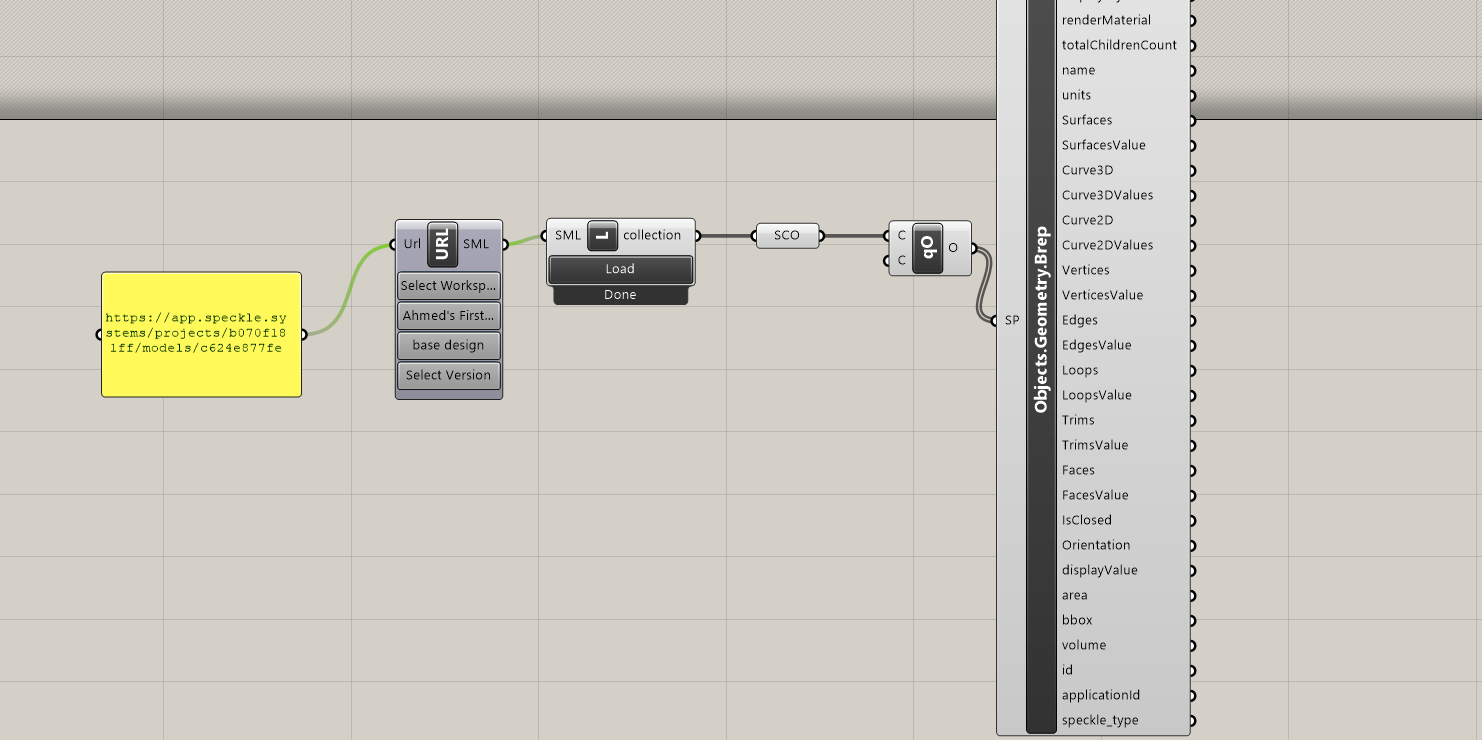

I tried utilizing the nodes from legacy and noticed they have changed in the new connectors… I was facing an issue where the model attributes have also changed, as I’m not able to use displayValue which previously held the structural data of the model…

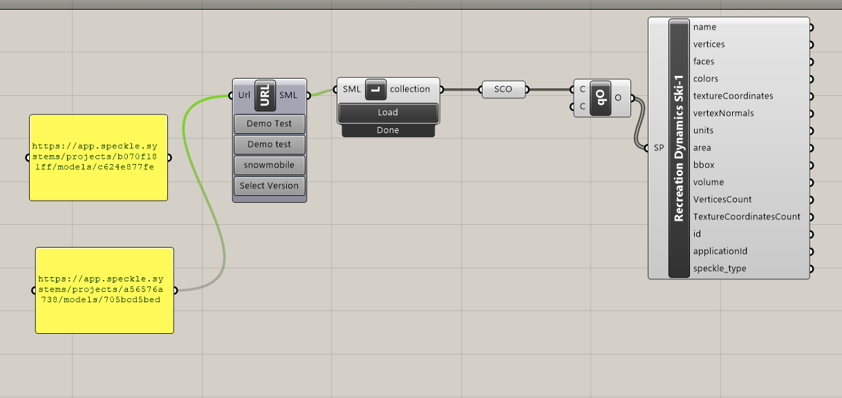

Sample model ( Using new connector ):
https://app.speckle.systems/projects/a56576a738/models/705bcd5bed

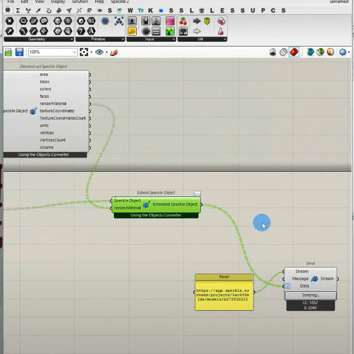

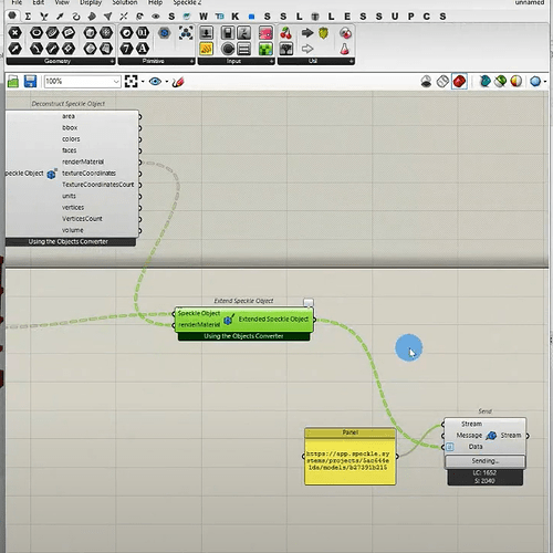

Legacy reference video:https://www.youtube.com/watch?si=caOX7FaSZnMfNeSL&v=SUiJrcVhU7M&feature=youtu.be
Structural Difference
OLD
NEW
Node reference from legacy:

So in general your next-gen Revit models are already more lightweight. Also, the Deconstruct node is not meant to be used as part of regular workflows, it is more of a developer node to help you access properties that are normally only seen in developer mode in the viewer.

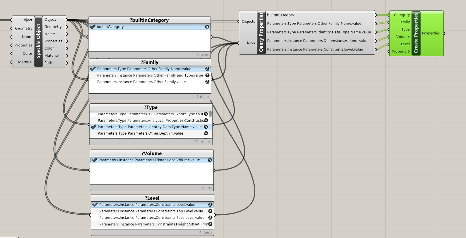

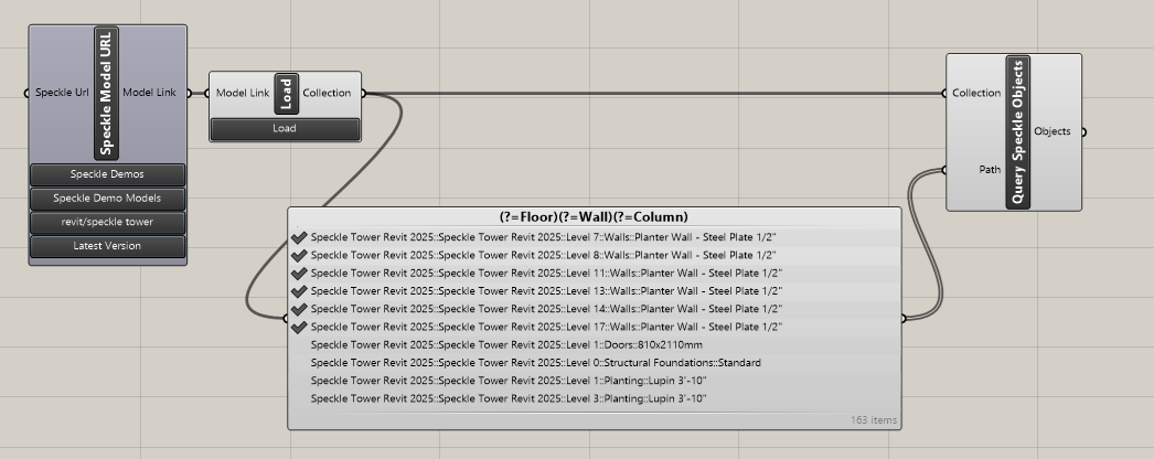

  1. filtering which objects to use by collection, using the Collection Selector node and a regex query to sort by floors walls and columns. Here I’ve only selected collections that are of floor, wall, or column types and will leave out any other type of object.
  2. create a new, reduced set of properties with the Properties Selector and Create Properties node. Here I’m only getting the category, family, type, level, and volume properties

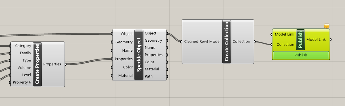

  3. override your original object properties with the new properties and publish
I would recommend waiting for the stable release, as we’ll have even better support for dealing with BIM objects from Revit/Archicad/etc by then.
