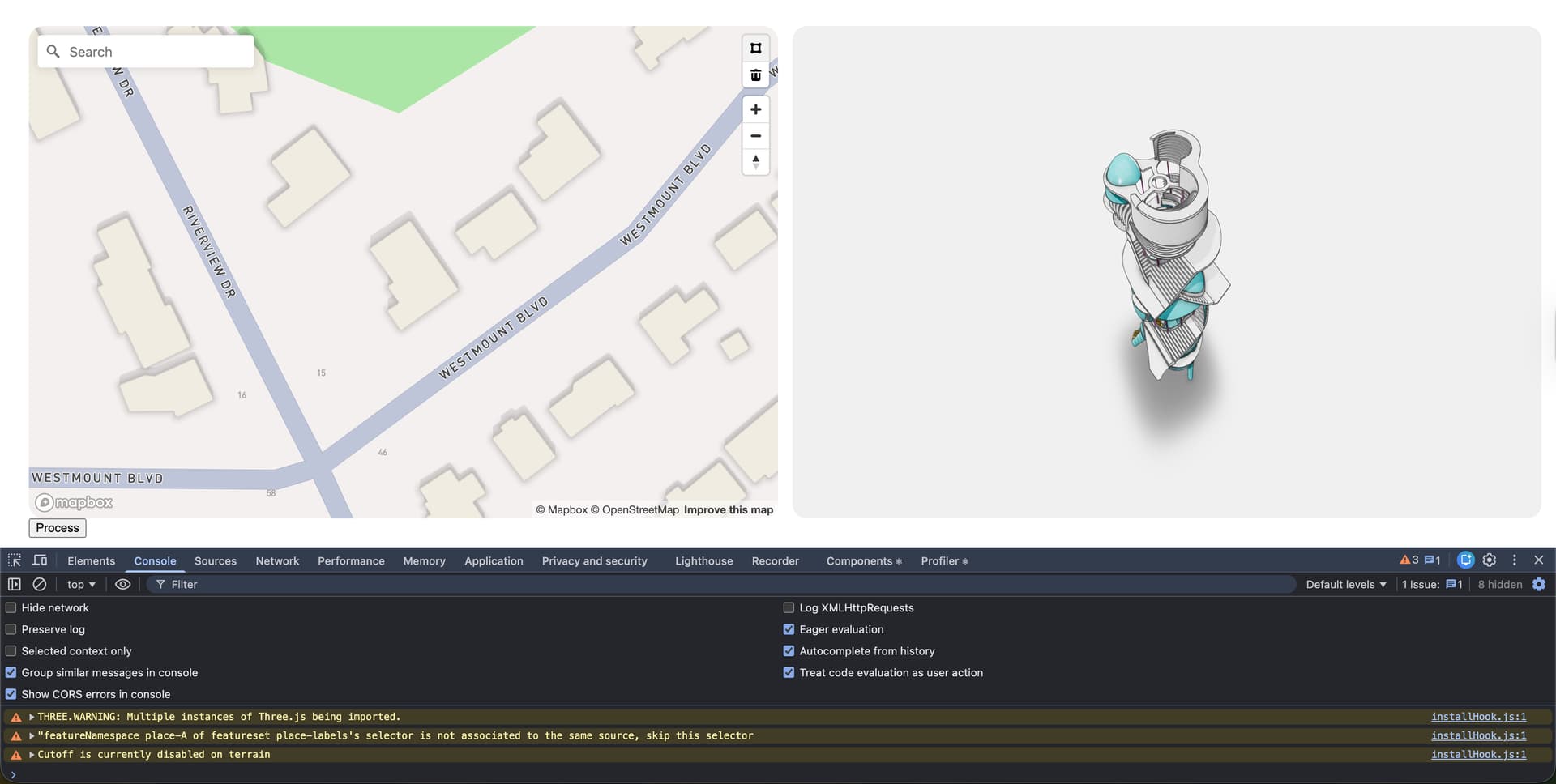

Is it simply just because I’m using mapbox-gl in one div (left) which is using Three under the hood and now Speckle (right) which is doing the same? Screenshot attached below.

I understand. I did try your solutions and I would have to force all versions of Three to 0.140. But if I’m using other apps like Mapbox that also use Three and maybe a newer version of Three, won’t doing that potentially break things? In that case I guess this warning is okay…
@aidannewsome The warning strongly implies that you should not have multiple versions of three.js running. Not only because the library is massive and bundling it multiple times is gonna meaningfully impact your app’s performance, but also because it clearly relies on some kind of singleton state that must not be duplicated. Even the three.js docs state this:
So if you’re worried about breaking things, you’re much more likely to break things running multiple instances of three.js than forcing all of your dependencies to rely on the same version instead. I don’t think forcing them to do that should be an issue at all, and if it is - then you should evaluate whether you should stop using incompatible dependencies.
