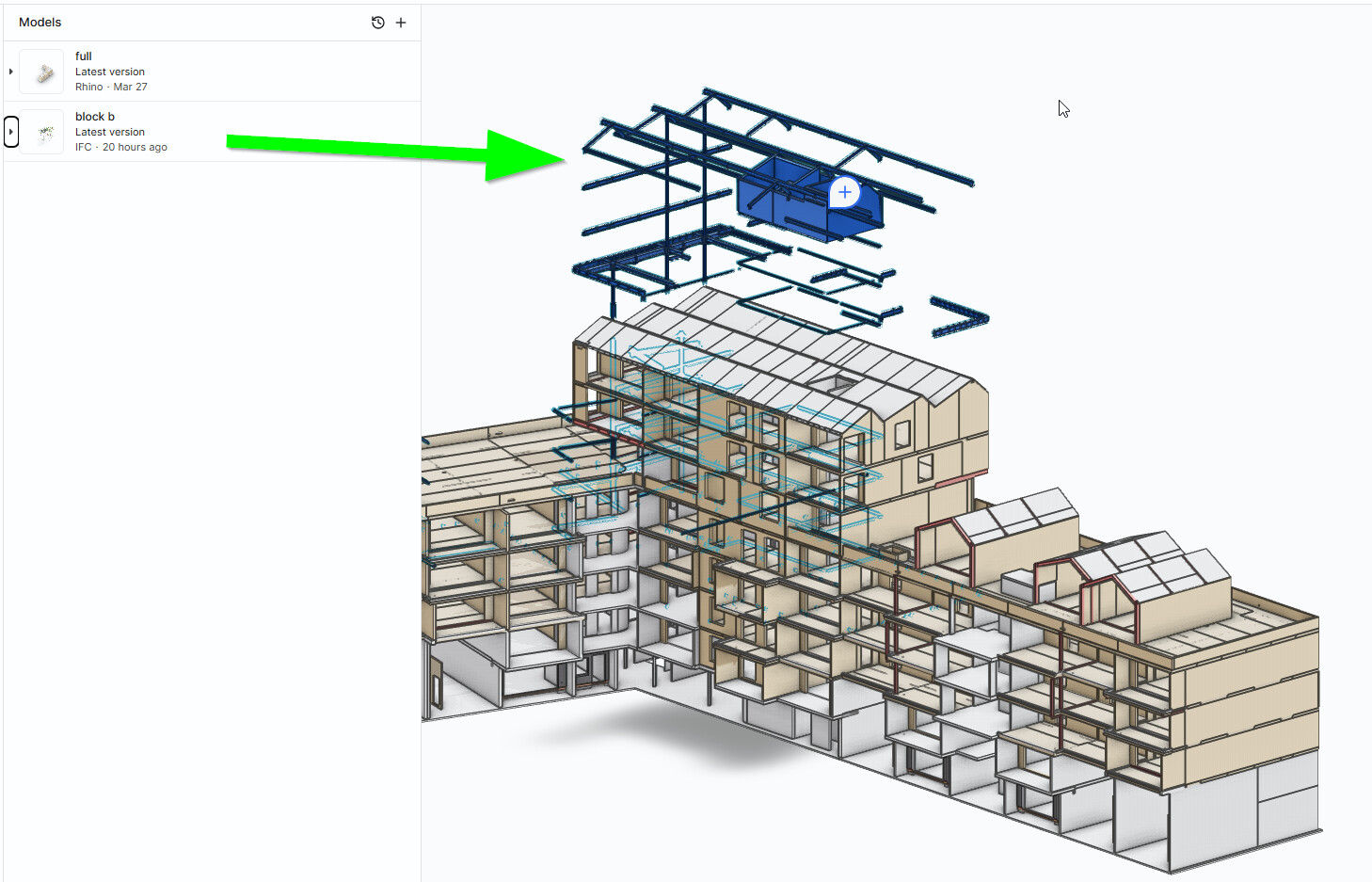

I don’t see a front end feature, but just in case - Is there a way move a Speckle model once it has been loaded into a larger federated model?
Example below
We received an external steel fabricators model, and now I want to check this in context, I will need to select the model and aligned it to a reference point in the main model.

Currently there is no builtin way of moving (or any other transformation) objects in the Speckle web app. You could achieve this by using the Speckle viewer library directly but that would imply building your own web app.

As a FYI - that is quite a limitation for us, I imagine for other people as well. When working on the design to manufacture side of thing, it is very common to received model that are no exactly in the correct place.
