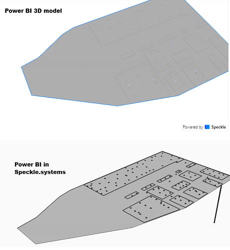

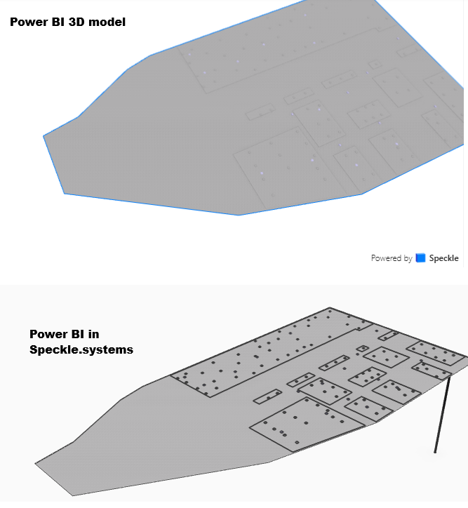

Thanks, Nikos. It’s fixed now — the 3D model displays successfully in Power BI. However, I noticed that the model appears unclear, especially in the detailed areas. How can I resolve this issue and make the 3D model in Power BI as clear as it is in Speckle Systems? Thanks.
Hi @judywu0102,

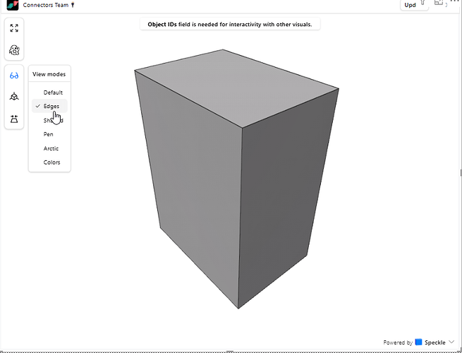

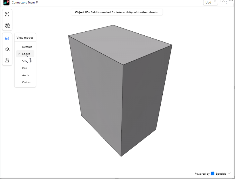

Did you check the view modes in powerbi visual? What happens if you change view mode to Edges?

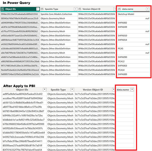

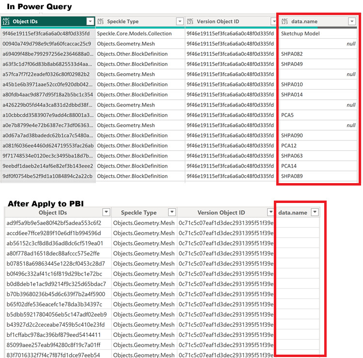

The issue is now fixed. However, I found another problem: the dataset name appears correctly in Power Query (Transform Data), but after applying the changes in Power BI, the dataset name content disappears. How can I fix this? Thanks.
Hey @judywu0102 ,
It seems you filtered out blocks, which may be the one that contains the name attribute.
