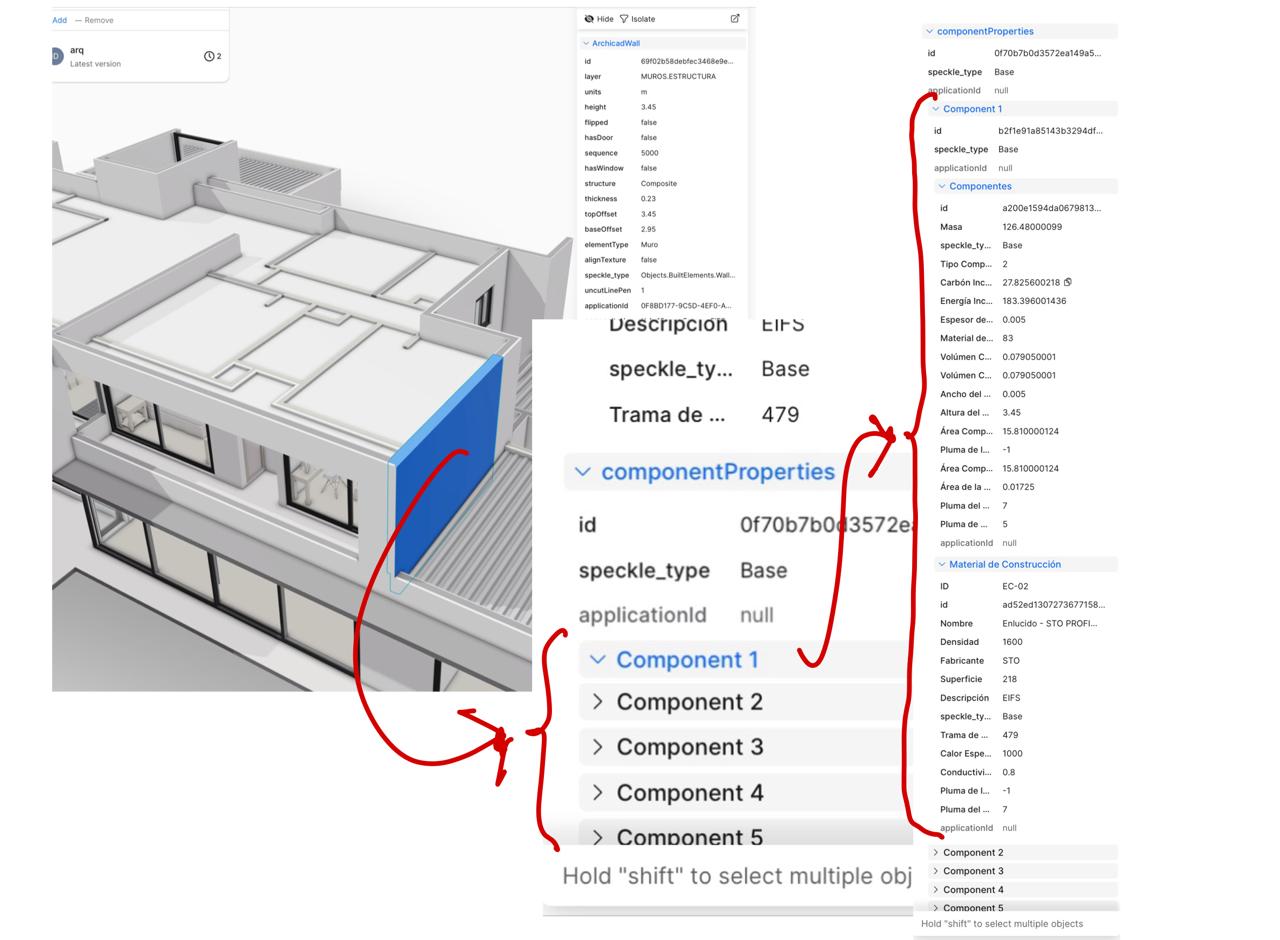

For example: In this project I have my composite walls (5 Layers) and in latest 2.x connector I could see this data as next image shows:

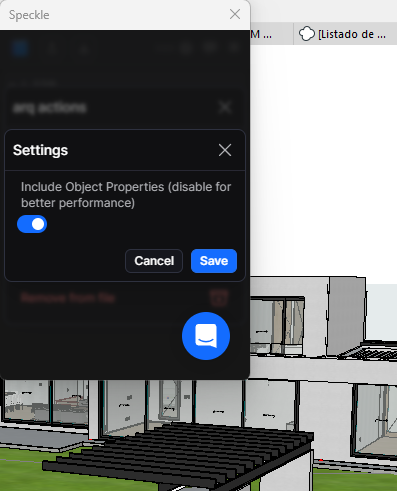

But now instead, we have fewer info although I took care in settings to “Include Object Properties” ON✅
So I can no longer see quantities for each layer. Maybe I´m missing something? anything else I can do? I would love to hear the way that I can continue in this.

Hey @Ignacio_Diaz
Currently we only extract the name of the composite materials from Archicad, but the building material and thickness of the individual layers is not exported.
The good news is that we already have a ticket in our issue tracking system to address this. You can expect a solution in the upcoming weeks.
