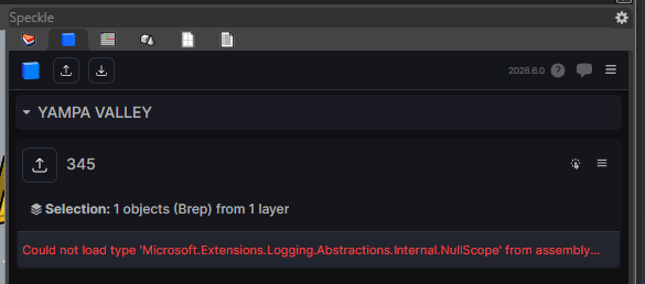

I’m getting this error when trying to send to Speckle. I tested with Extrusions and Blocks.
Microsoft.Extensions.Logging.Abstractions.Internal.NullScope
I’m in Rhino8
Thanks,
Dan

The error message in your screenshot indicates there may be a conflict with something else loaded.

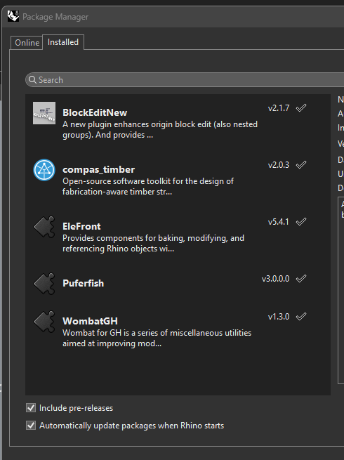

I have uninstalled some recent plugins I added, but I’m still getting the error.
Do you know if any of these could be the issue?

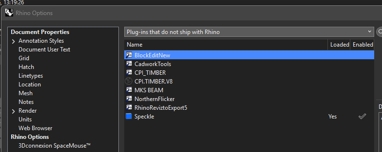

I disabled all external plugins except for Speckle and I’m getting the same error
These plugins have been on my machine for a long time, so I’m having trouble figuring out who the culprit could be.

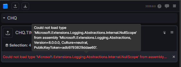

And on Speckle 2026.6.0
Models are created in the Speckle web interface, but there isn’t anything in them.

Can you reproduce this problem with no rhino plugins installed other than Speckle?
@Jedd
With no other plugins installed? Or no other plugins enabled?
Should disabling a plugin be enough, or do my other plugins need to be completely removed?
Thanks,
Dan
Best to fully remove
