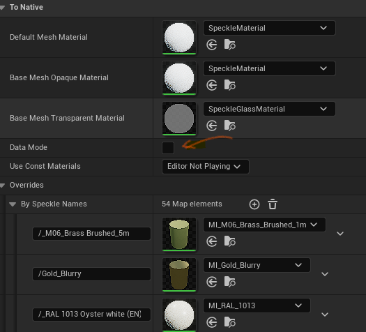

We have modified the material conversion by adding a “Data” Mode" that automatically fills a list of materials to convert by string name, and then you just have to choose the corresponding EU materials.
This “Data Mode” can be triggered even after, to add new materials.
Ah so you have the materials dictionary populate after conversion?
I can see this being much friendlier to interface with :raising_hands:

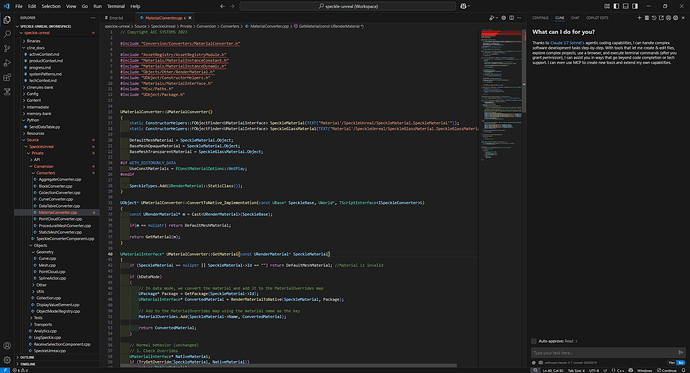

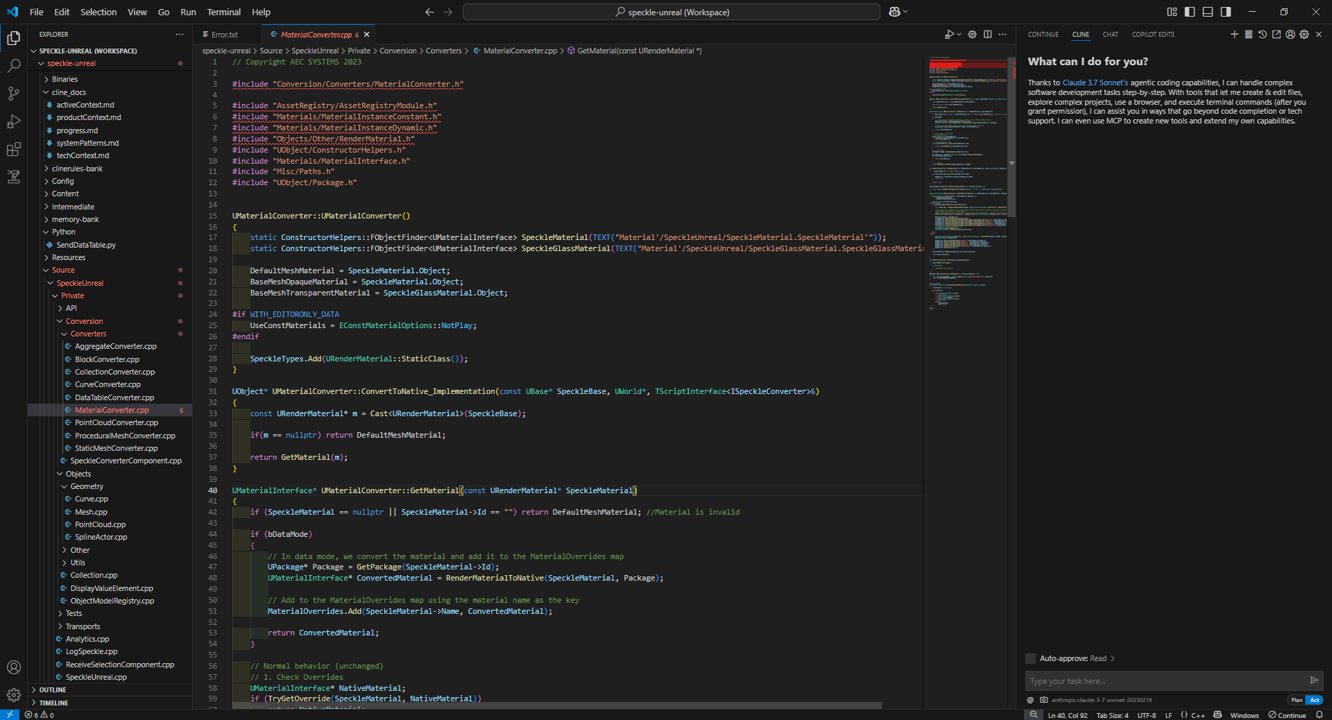

Here is a link → MaterialConverter.cpp · GitHub
By the way i’m also working on others converters ( VScode+Cline+Claude 3.7 workflow )
