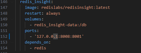

..\speckle-server\docker-compose-deps.yml
change port to 8000

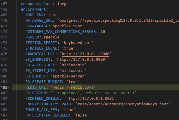

..\speckle-server\.circleci\config.yml
image (1)
change url to redis:6379

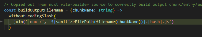

..speckle-server\packages\frontend-2\nuxt.config.ts
unnamed (1)
remove leading slash from /nuxt/

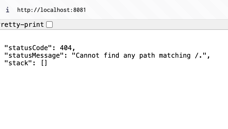

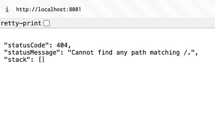

Refreshing the page (sometimes refreshing doesn’t do anything, so closing the tab and opening a new tab and going to localhost:8081) returns a page with the message:
If I send SIGINT in my terminal windows running the frontend and server and then spin them up again with yarn dev, everything seems to be working as expected. Any thoughts on why I have to kill it once and relaunch?
@tycecycle - I’ve been able to recreate the Page Unresponsive issue (MacOS and Firefox when running yarn dev). This is unexpected, we’ll take a look.
