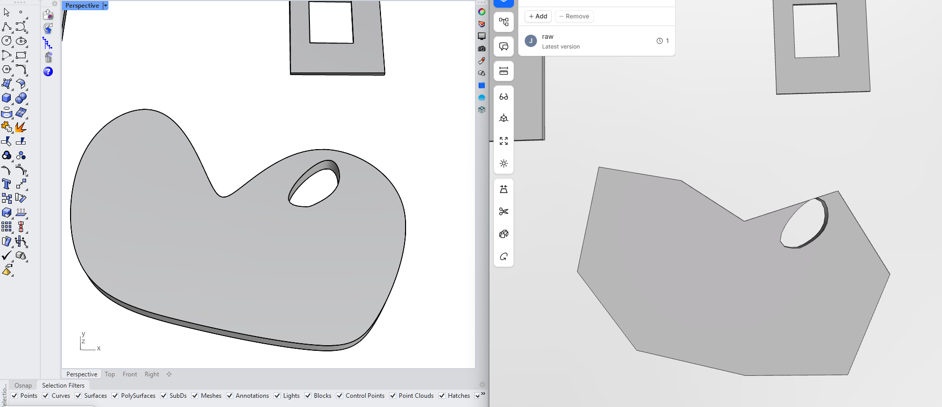

Hi Speckle Team,
I am facing issues whereby curved extrusions/polysurface from Rhino sent to Speckle gets previewed as a polyline extrusion. Pulling back from Speckle to Rhino, it is still a curved extrusion/polysurface
Hi Speckle Team,
This is most likely due to how the rhino connector extracts the mesh from the extrusion (our brep, extrusion, and subd geometry is sent as the solid data plus a display mesh, which is what you see in the viewer). What is the size of that geometry? We can open a ticket to investigate our meshing parameters.
Hi @clrkng , I have attached the rhino file
Curved_Extrusion_Meshing_Error.3dm (130.4 KB)
