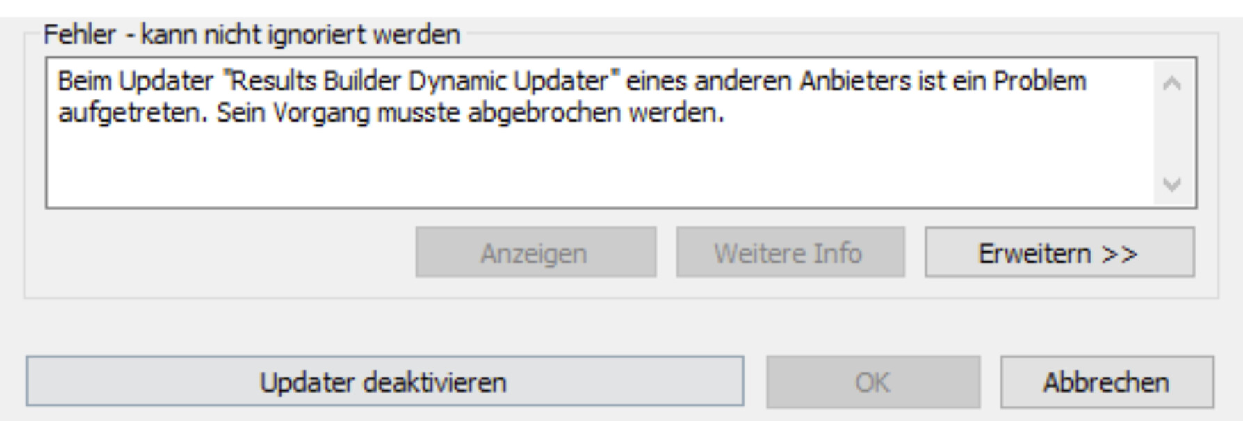

Hi @teocomi ,
I’m following up on my earlier post about sending data from Revit to another file using Speckle. I tried sending the elements again, and it’s working now, but my colleague is getting this error:
Copy
A problem has occurred with the Updater Builder Dynamic Updater from another provider. Its process had to be canceled.
My Questions:
Could this error be related to Speckle?
Does Speckle use anything related to the IUpdater Interface or Dynamic Model Updater? (Like the one described in this blog post)
I’m not using any updaters in my scripts, so I’m trying to figure out if this is coming from Speckle or something else.
Thanks for your help!
Hi Reb,
Our connectors do not use the IUpdater interface as far as I’m aware. Your colleague can try removing the installed addins one by one until the error goes away to find the responsible one…
Glad you issue is resolved!
Hi @teocomi
Thank you for confirming that Speckle does not use the IUpdater interface. This helps narrow down the issue, and I’ll focus on investigating other add-ins.
As you suggested, I’ll work with my colleague to remove add-ins one by one to identify the culprit. The error seems tied to Autodesk Results Explorer or a third-party tool bundling it, so I’ll start there.
Thanks again for your help—it’s great to have this clarified!
