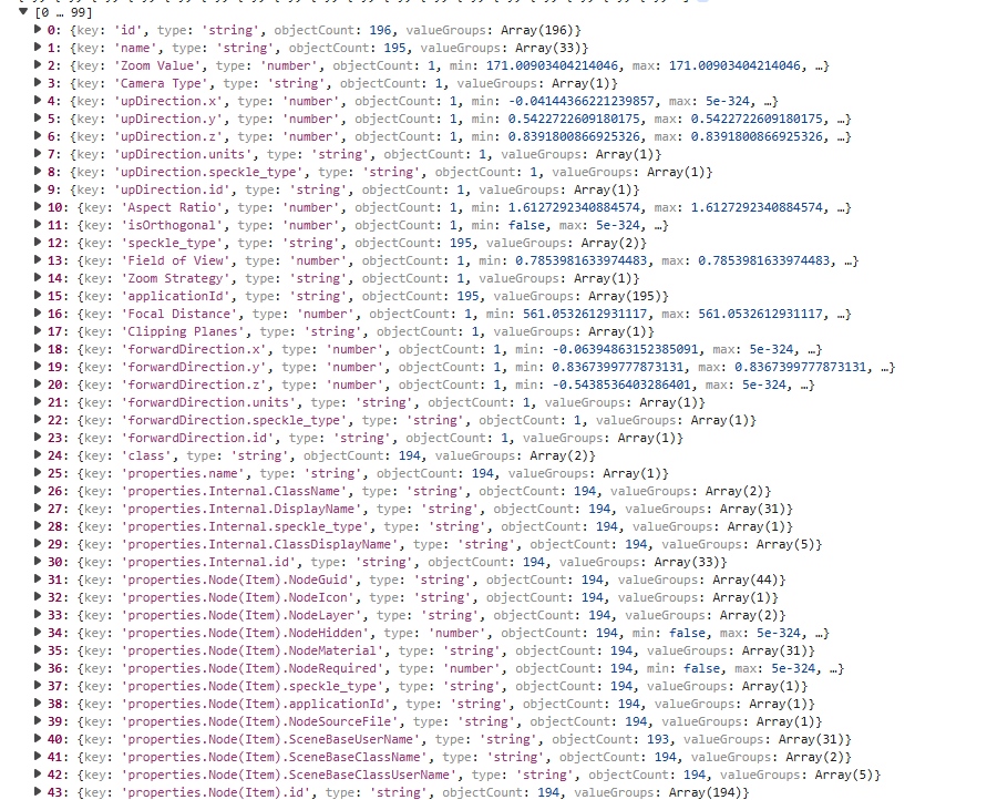

I have developed a software program in which I need to retrieve a property called ifcGUID, which corresponds to a specific identifier.
However, when I use the getProperties() method and browse through the returned data tree, I notice that the ifcGUID is no longer present. Instead, other property names are used for identification. ( example : lcldrevit_parameter_-1019000 )

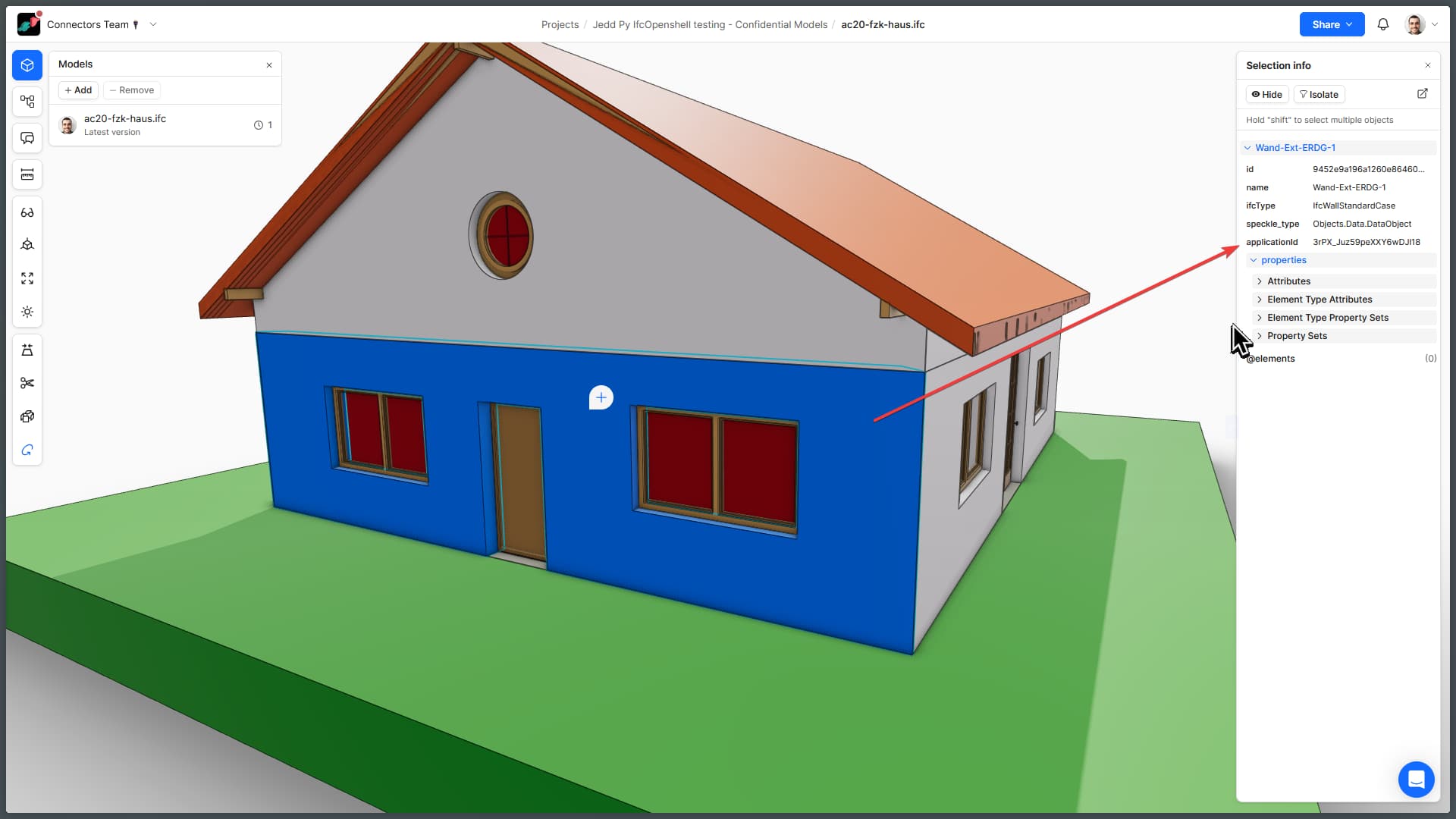

IFCGUID is stored under applicationId field. applicationId field corresponds to guids from the source applications we support.
PS. You can also find it under Attributes > GlobalId.

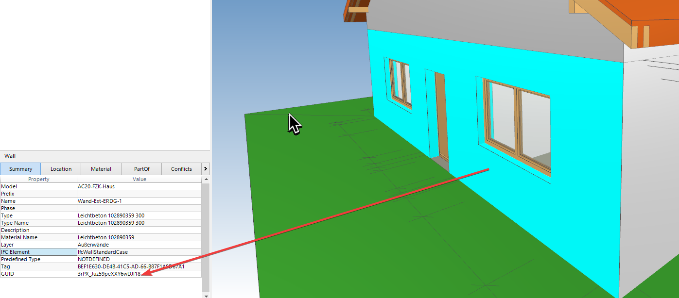

Is this what you wanted?
evc - BIM_SYSTEM_PROTOTYPE | Speckle
@Mathilde i thought you were dealing with IFC files since you were asking for IFCGuid. It seems you are sending from Revit.
When you say getProperties function, is this from the viewer package?
Yes, but what you are sharing is a Navisworks model and not a Revit model.
can you share the Revit model that you screenshot this image?
@gokermu

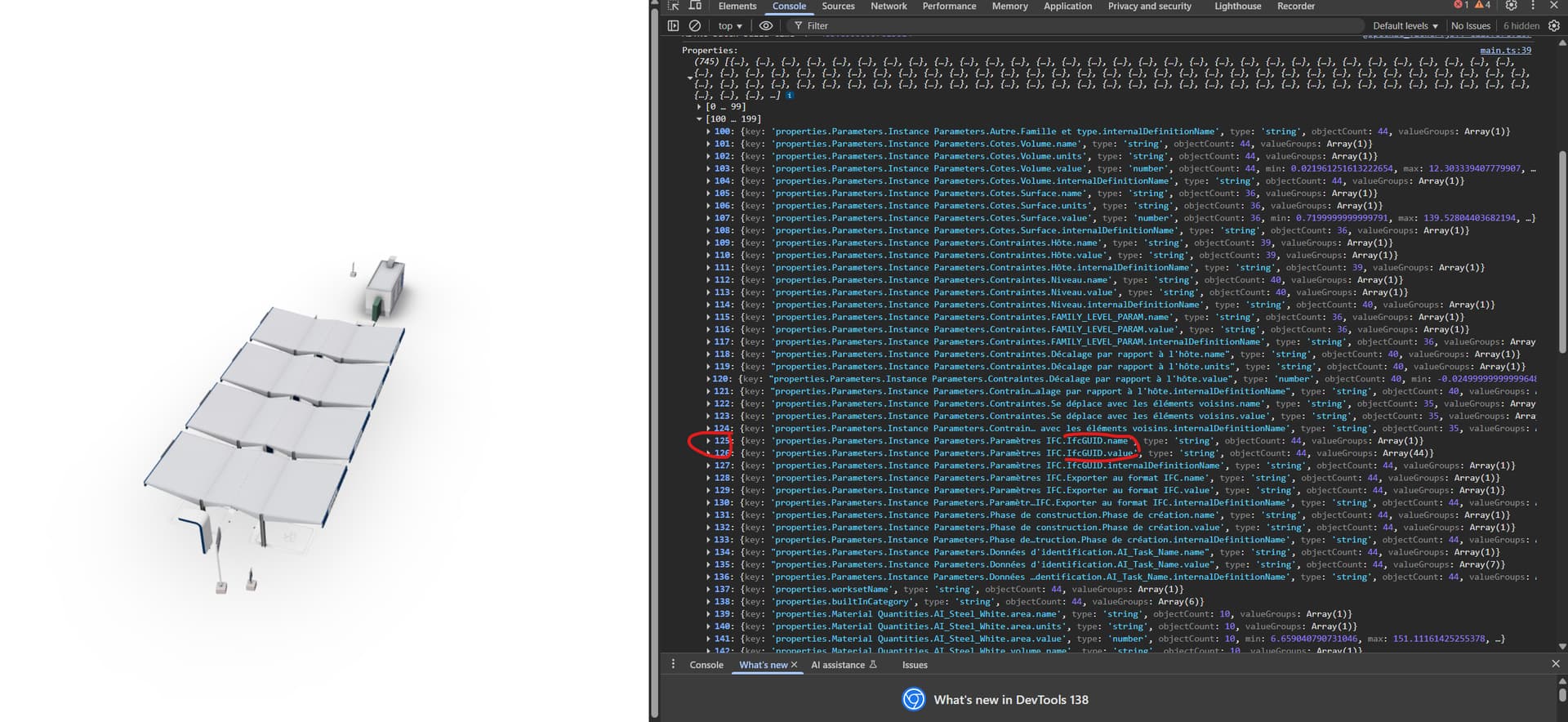

Sorry, I’m using this function: const pro = await viewer.getObjectProperties();

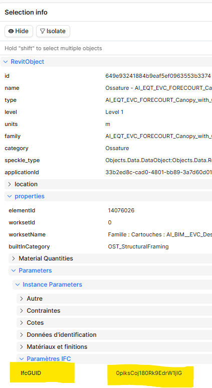

Can you check line 125, 126 - the property is there
the path is “properties.Parameters.Instance Parameters.Paramètres IFC.IfcGUID.value”
