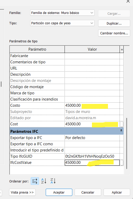

  • Exporting the material cost per m² → it doesn’t show up in the Speckle table in Power BI.
  • Adding a cost parameter by wall type → no luck either.
  • Creating a manual IFC parameter (ifcCostValue) → it doesn’t get saved or linked as a property in Speckle.
  • Even tried creating a parameter named Cost (in case it was a language/label issue) → still no success.

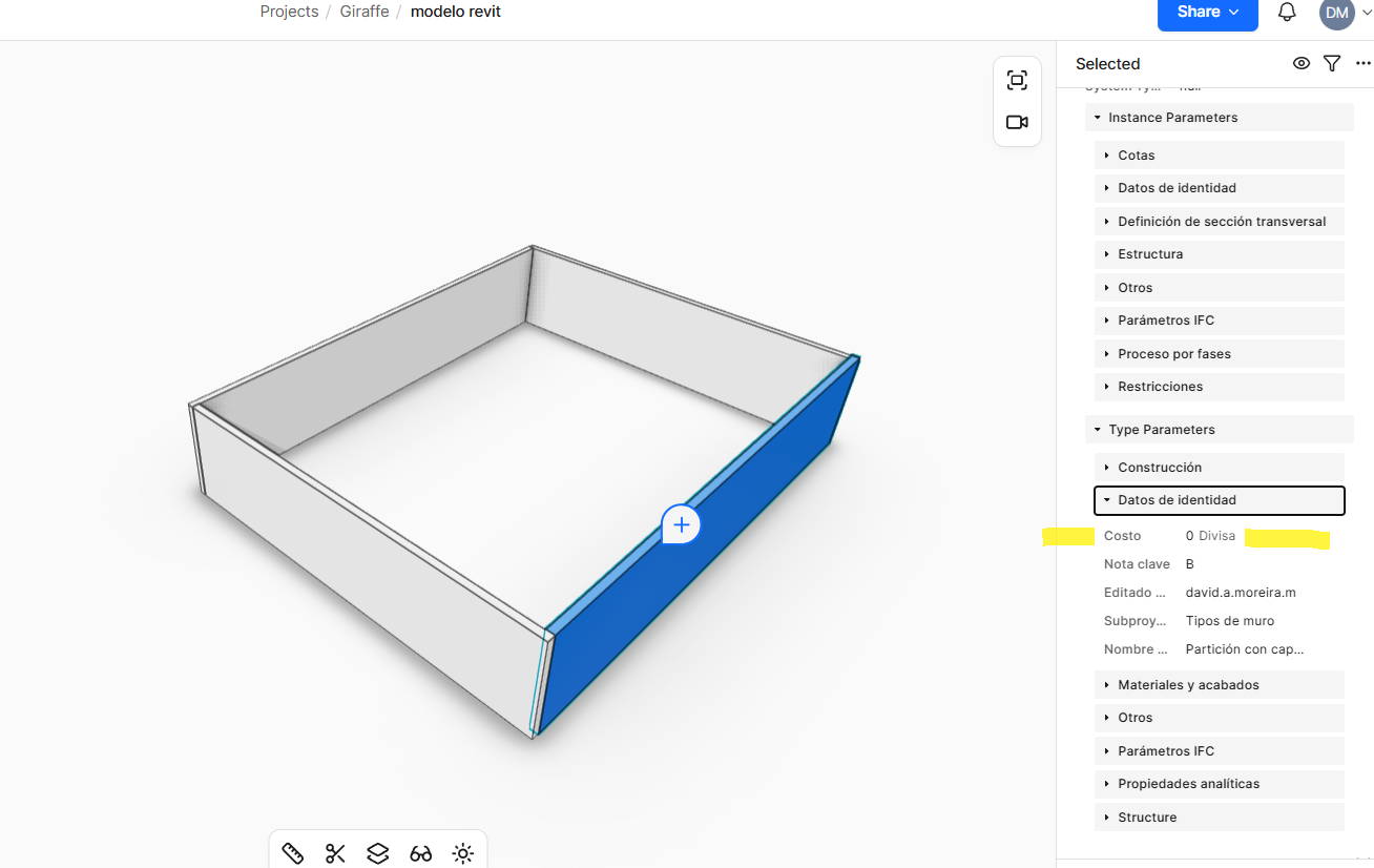

I’m attaching a screenshot of how it currently looks in Power BI.
:backhand_index_pointing_right: Question:
What’s the recommended way to expose and query wall costs in Speckle so I can calculate cost / area in Power BI?

Hey @David_Moreira, can you please reupload the images and also share your speckle model url if possible. Thanks!
Hey @Nikos , Of corse
Thank you

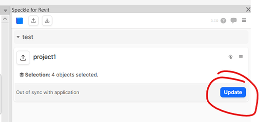

Thats, a bit weird - Cost is a parameter that we publish.

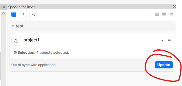

Question: When you update the Cost parameter in Revit do you see the option to “Update” in the connector?
Can you try to restart Revit and re-publish again?
Hi Nikos,
Yes, the Update button does appear (please see the attached screenshot).
I republished it, but it still doesn’t work. I also tried adding costs by material, but they don’t show up either.

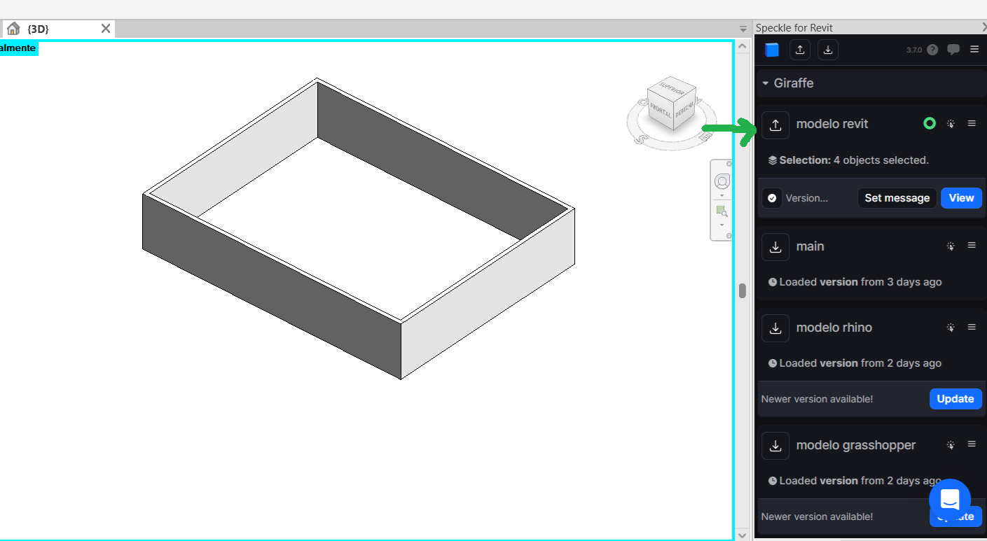

Hey @David_Moreira,
Would you mind trying the following:
  1. Remove the modelo revit model card
  2. Publish the selection of 4 walls to the same speckle model (effectively creating the same model card modelo revit)
  3. Adjust the cost parameter
  4. Hit update
Do objects in the viewer then reflect the updated cost values?
Thank you so much, Björn! I did exactly what you suggested and it worked perfectly — problem solved. :smiley:
