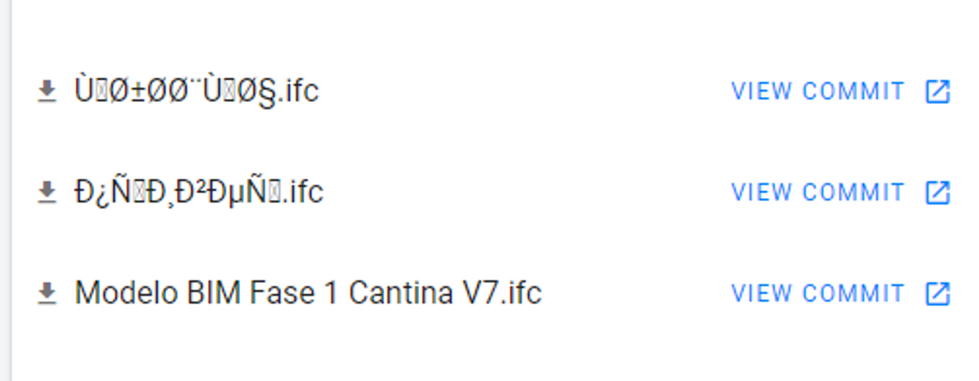

It seems that Speckle doesn’t know Cyrillic characters :c

Hey @Maks_T ,
Sorry for the late reply. I just tested this and yes, it seems we are not storing the text from other alphabets correctly. And looks like this is an issue specific to the file import service. I was able to create a stream with a Cyrillic/Arabic alphabet. But I believe this doesn’t affect the conversion process. You can still view your IFC file in the viewer, right?
I created an issue for this. Thanks for reporting👌

The file import service does not correctly display the names o… f files that are not written in latin alphabet.
Looks like this issue is only present in File Import service. I was able to create a stream with a Cyrillic name and a branch with an Arabic name.
## Expected Behaviour
Displaying the names of files as they are in Cyrillic/Arabic or any other alphabet.

File names in Windows 👇
File names in Speckleverse👇

Yes, I can view file in viewer, the problem is only with the distorted file name
Maks_T
(Maks T)
December 19, 2022, 8:25am
5
So when I am downloading this ifc file from the server it has distorted name
