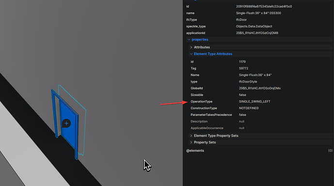

I’ve uploaded an IFC file to my Speckle server and noticed that quite a lot of properties are apparently not parsed to Speckle data? For example, I’d like to find the door swing direction of an IfcDoor in a very simple IFC file (IfcDoorTypeOperationEnum), but I don’t seem to be able to find this info anywhere in the Speckle data. In fact, the amount of data I’m seeing for my IFC elements is suspiciously low in the first place.
Am I not looking at the right things or are certain properties not supported yet by Speckle?

Glancing over the code you provided, it seems like you’re only extracting the IFC Item Properties, not the remaining ones, e.g. Type Properties (see 📃 Properties | IFC.js). Is this by design?
Defs not by design, but rather by omission/lack of experience :gift_heart: Thanks for the spot. I’ve added your insight to our ticket. We haven’t picked it up yet. If by any chance you want to, we could help out on how to set up stuff for debugging.

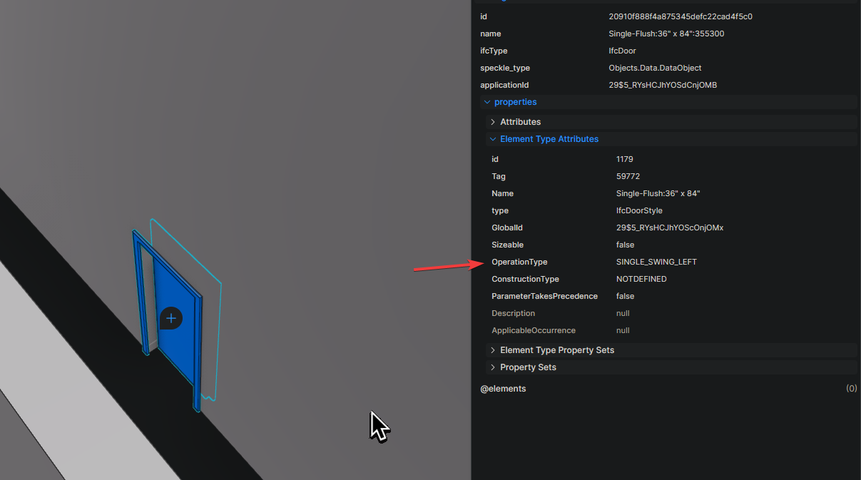

New IFC importer supports IFCDoorTypeOperationEnum. Check it out!
Better late than never!
