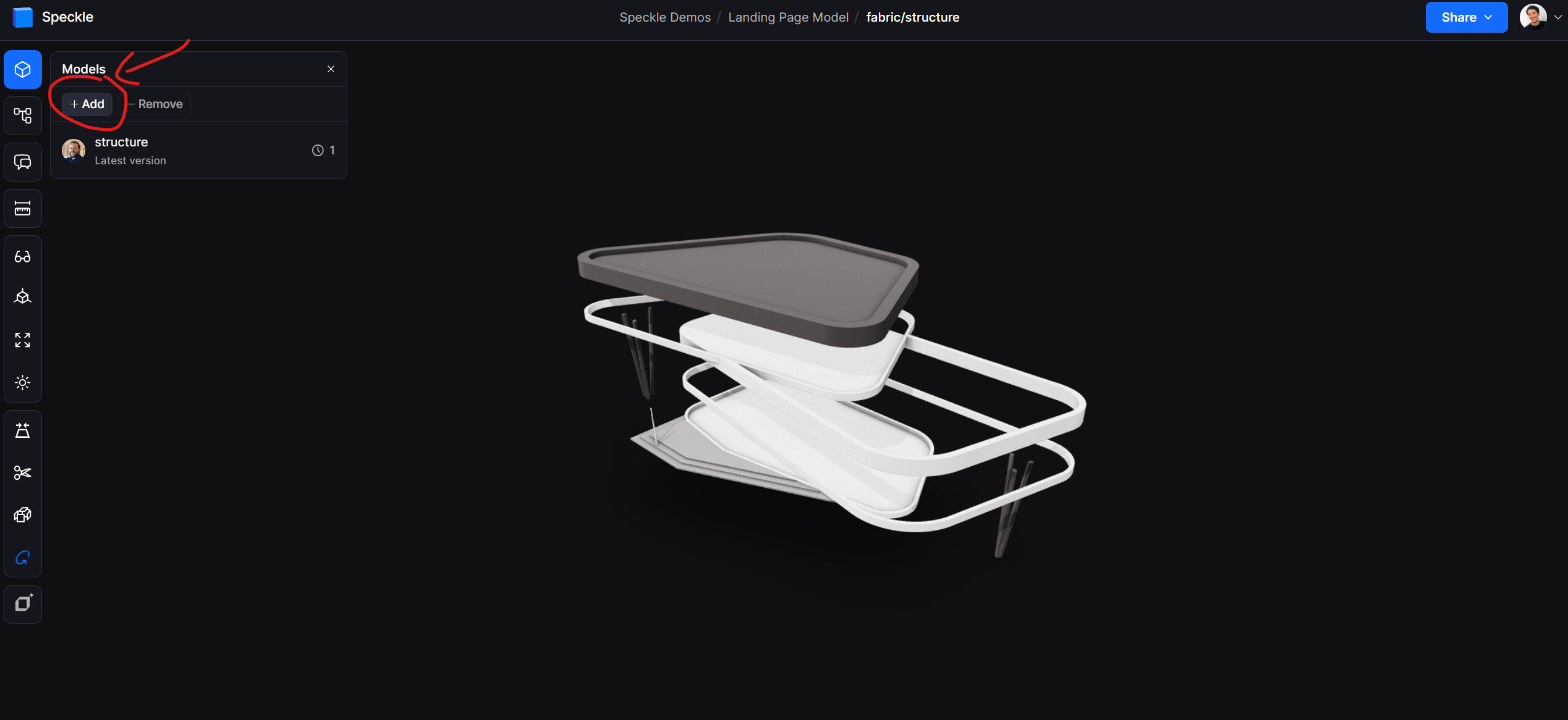

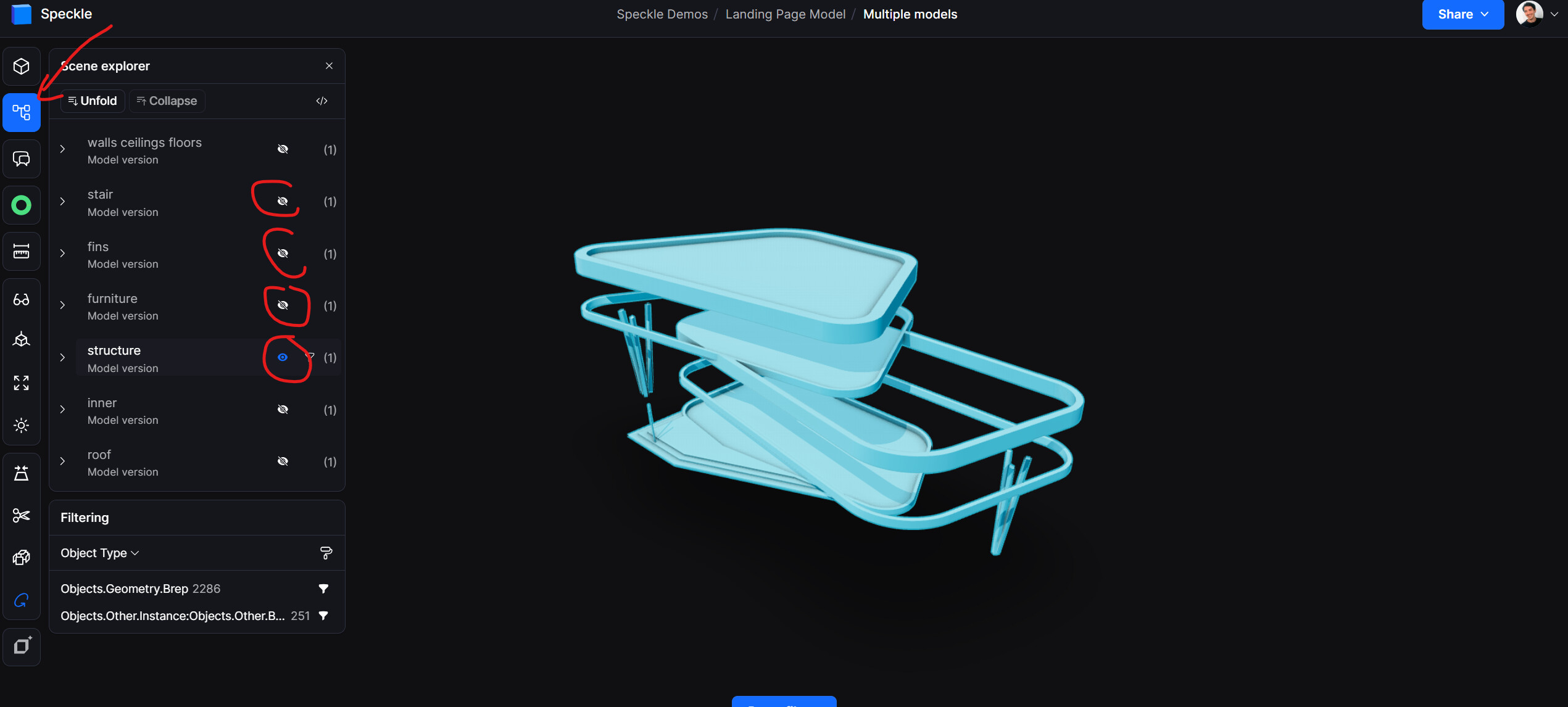

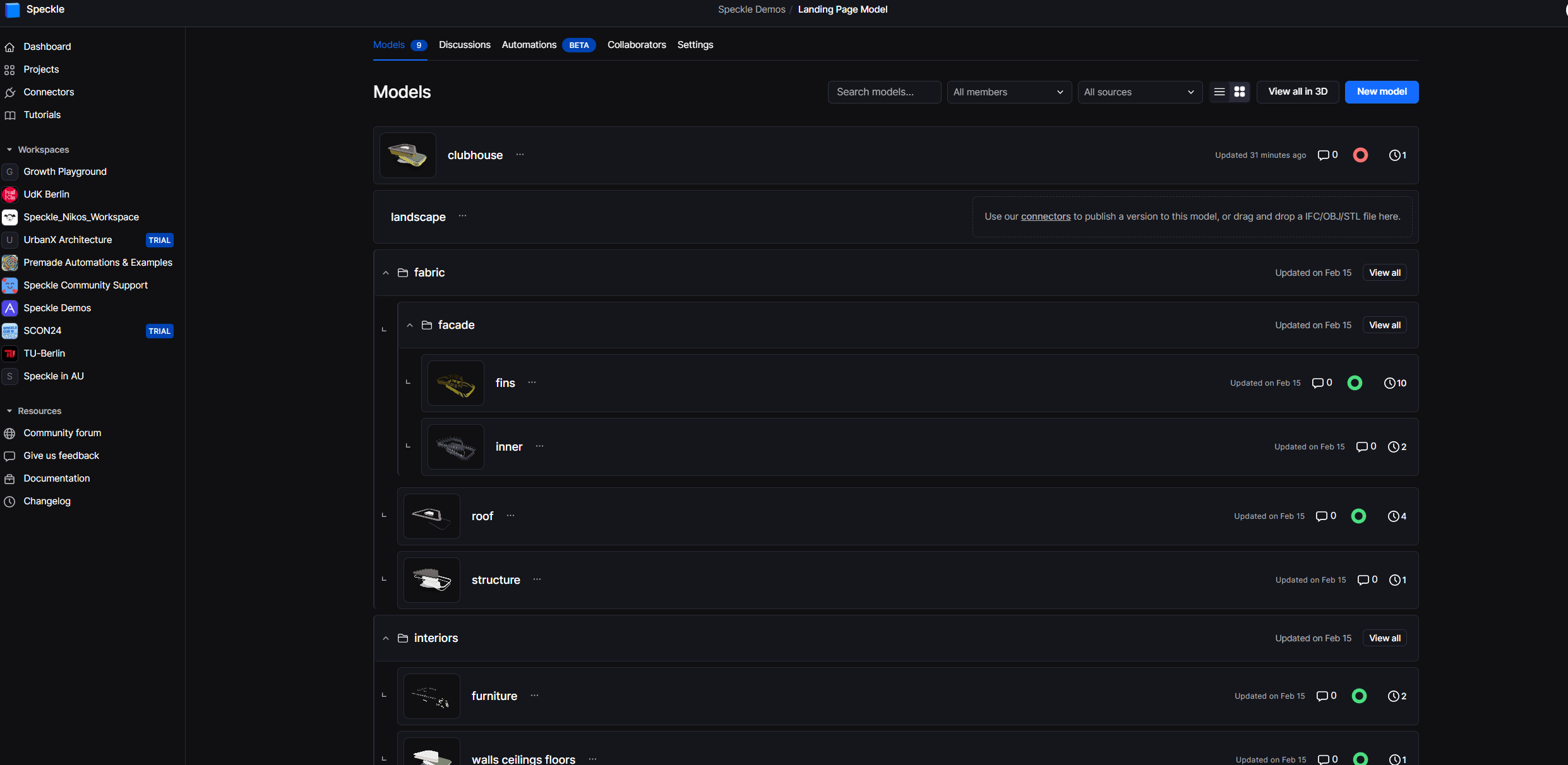

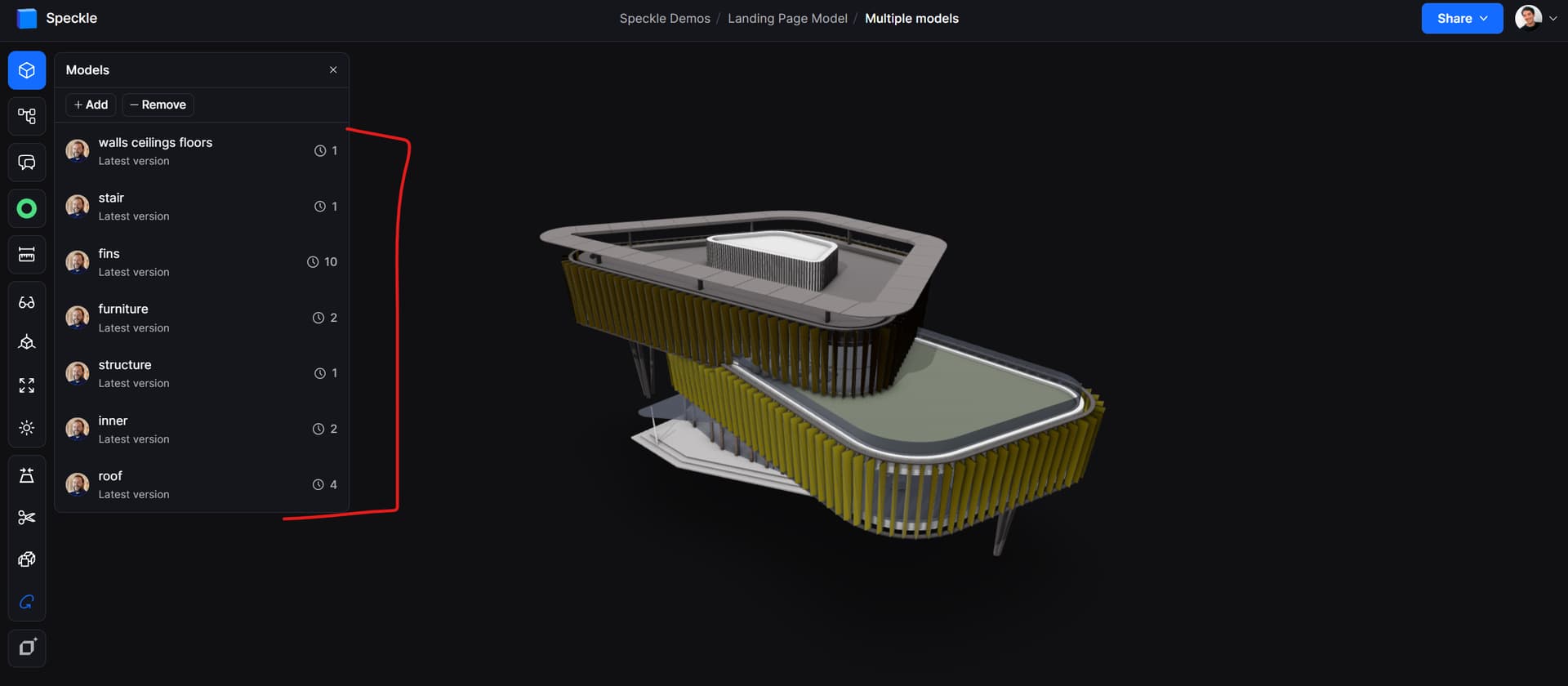

Another way to do this is to split your model into multiple models, then federate them all together. Next, you just need to toggle the hide/unhide button the way you like.
