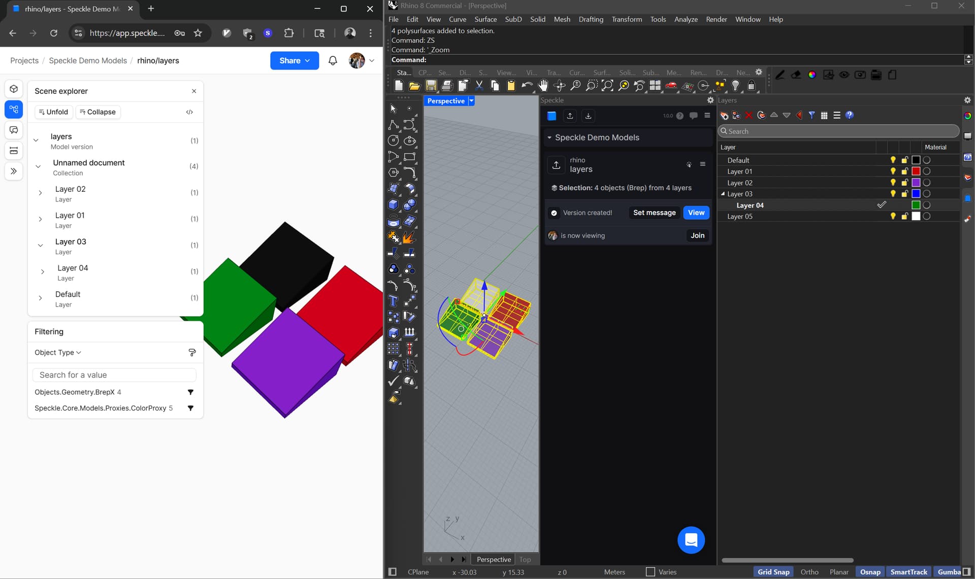

I want to publish a Rhino model into Speckle and be able to select the same layers that I had in Rhino and use a hide/show tool.
However, there is no sign of the layers in the explorer of my model. Furthermore, I tried to use Grasshopper to publish my model (instead of just publishing by selecting the layers in Rhino), but I only have Speckle and not Speckle 2 displaying in the toolbar, even though I dowloaded the latest version of the plugin. I therefore don’t have access to a lot of components required.

Hi Lilia, we probably can help! Screenshots help & also connector versions.
For rhino, we actually respect layer structure really carefully, as well as the colors:
(https://app.speckle.systems/projects/8be1007be1/models/7c7151f48d)
To get that, you need to choose the “shaded” display mode from the :glasses: button on the side.
Does this help?
Yes, it did ! Thank you for the help
