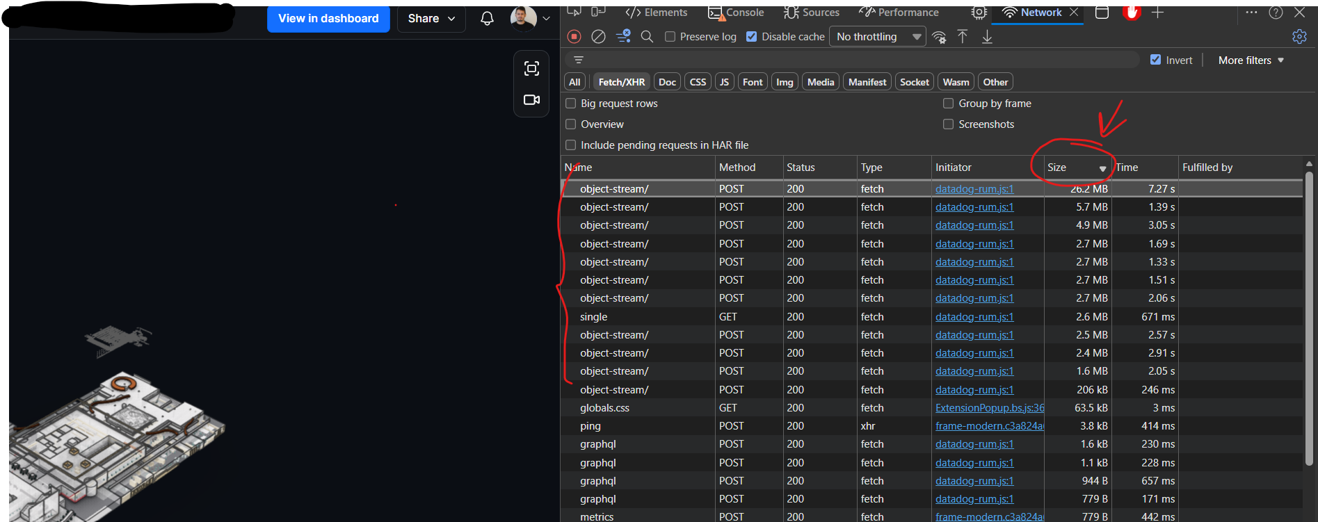

Since you mentioned it is for an article, you can do something simple. You can open your browser developer tools and take a look at the network tab. You can filter the requests related to fetching objects and do some simple math, see image below.
Now be aware that this is a simplified experiment. This is the size of the data transferred from the server to the viewer. Which is different than the size of the data stored on the database, for that you would have to go on a rabbit role of running a local server and looking at the storage layer.
Make sure you clean your browsers cache between measurements (perhaps do it from an incognito window)
Good luck on your research!

You are right, the WorldTree will not hold on to geometry data for efficiency purposes.
Like @vwb suggested, the easiest way to get an idea about data size coming in would be through the browser’s dev tools. Alternatively, since you have your own custom viewer, you could compute the size yourself, but it might not be worth the hassle
