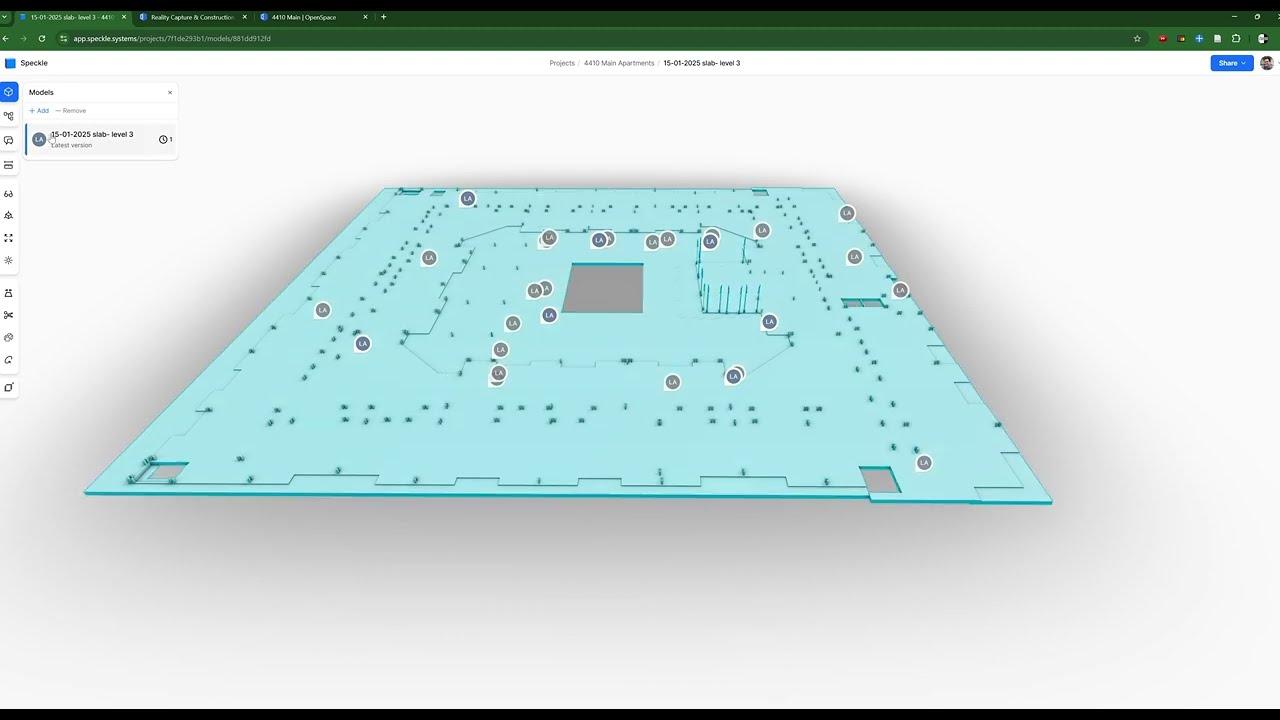

I’m loving the new viewer, and the comments in the Discussions tool in the web viewer are great, but I have ran into a couple of speed bumps.
1- If I misspell something in my comments, I can’t seem to edit them. Is there a way to do that?
2- If I want to delete a comment in a discussion bubble, I can’t seem to do that either. Is there a button I’m missing?
3 - When I mark a discussion as resolved, I can’t find it anywhere after I’ve resolved it. Under “Discussion visibility options” there is an option that says “Show Resolved (0)” even though there is one resolved discussion. It also doesn’t allow me to click the circle to show the resolve, turning my cursor into a red cancel circle.
4 - Is there a way to programmatically send viewpoints as comments to the Speckle Viewer using the API? I’m thinking coordination issues from other platforms would be awesome to visualize here (Navisworks, Newforma, ACC, Revit, Procore, etc).
Here is my model in question, I am working on my Master’s Thesis here at BYU on how to use BIM 3D models to teach construction sciences. We are hoping to use Speckle in the classroom to teach basic mechanical, plumbing, electrical, framing and safety principles in a 3D environment.

Hi @bowen_utahbim. Thanks a lot for the thorough feedback and video! Improving the commenting feature is on our roadmap so this is all golden.
To answer your questions:
  1. No way to edit a comment (yet?).
  2. No way to delete individual comments in a discussion thread (yet?).
  3. Good that you found out why the unresolved comment didn’t show up.
    I’ve made a note that these discussion settings – and the interplay between them – could be better explained.
  4. Can you elaborate on the workflows you think we’d unlock if we enabled programmatically sending viewpoints as comments using the API?
  5. It’s not possible for admins to control how the discussion settings apply to everyone loading the model in the viewer. Do you have a specific settings combination in mind that you’d like to always apply?
  6. Moving comments: To be honest I just learned from your video that comments can be moved :sweat_smile: I never noticed this – so thanks for teaching me that. Sadly, another no: At the moment comments always appear in the place they were created. We’ve received similar feedback in the past that comments can sometimes be in the way, so this is something I’d like to explore. Either we 1) make it easier to move them, 2) change it so that comments always appear next to the canvas, 3) make sure comments always appear next to the highlighted object instead of on top, 4) a combination of these or something I haven’t thought of yet. We’ll keep this problem in mind as we improve the feature!
