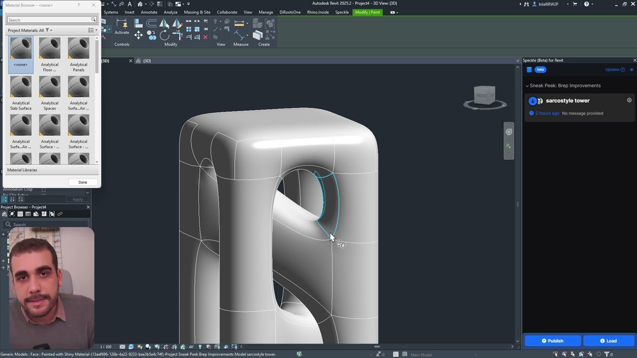

:light_bulb: Bonus: Here’s a sneak peek of the new brep conversion in action:

Just one question, does it allow you to assign materials parameter now? If I load it as mass?
Not yet. We’re getting there…
