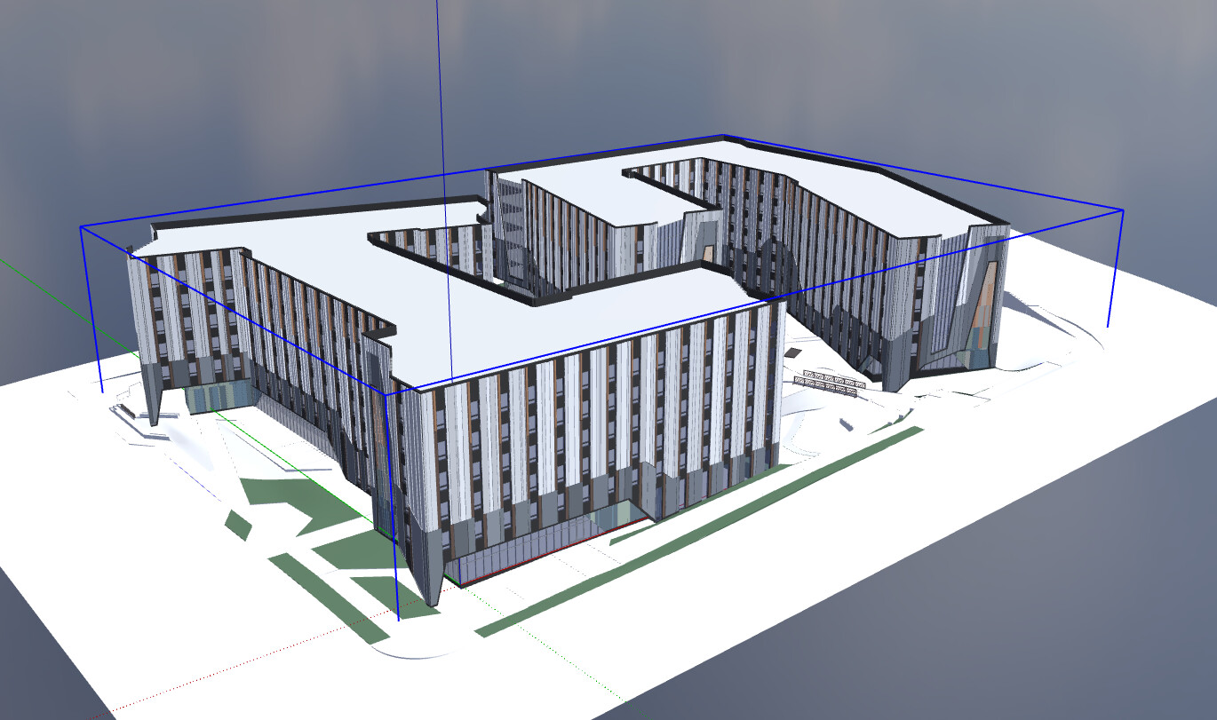

What I see in SketchUp:

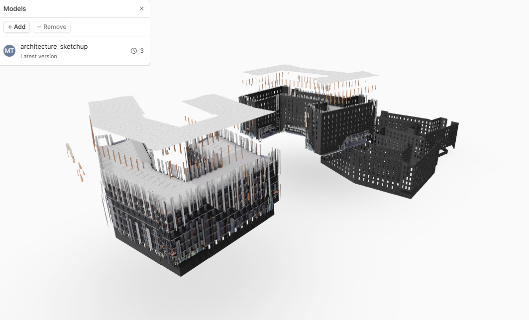

What I see in the Viewer:
The model is separated into individual groups per material. I tried resetting the position of all the group axes using the axis tools plugin, but I get the same result. Something is not handling the transforms correctly.
Any ideas?

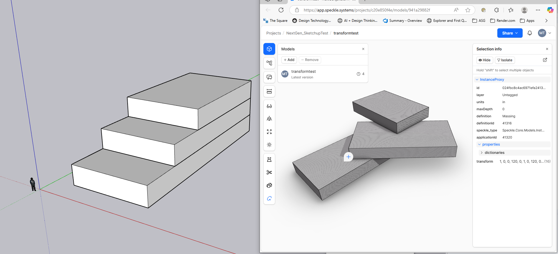

After a short investigation, Its actually very easy to recreate. Here are the steps:
  1. Create a component with several sub components.
  2. Publish to speckle using the 3.1.3 connector.
  3. Open the component and edit the axis location of the child groups.
  4. Update the speckle model
  5. see that the transforms are incorrect in the web app.
  6. After this occurs, nothing will correct the model, not even a new speckle model.
