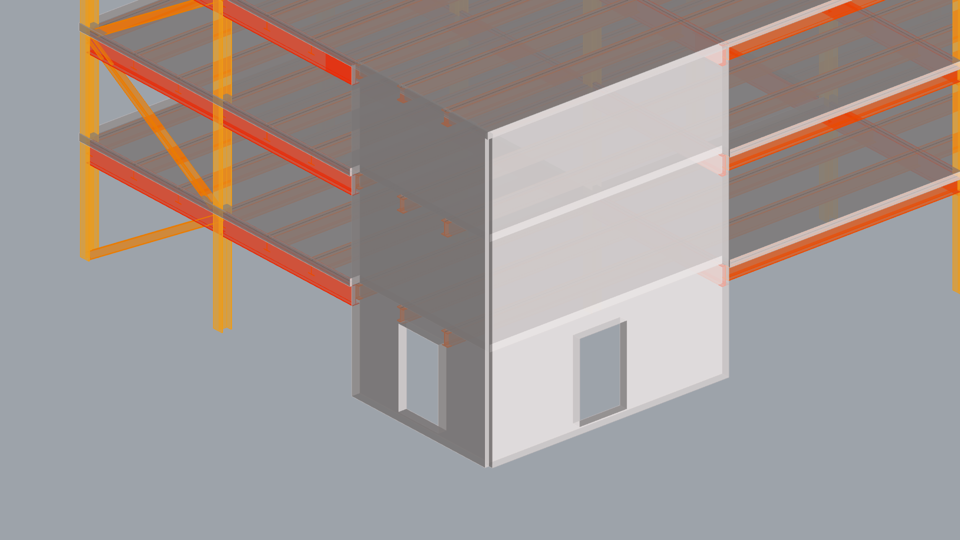

GH definition is below. I just have two walls, and a void in each. I cannot see any error messages in Grasshopper or Revit.
What I see in Revit:
What I am hoping to see, from Rhino
