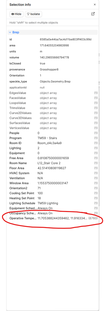

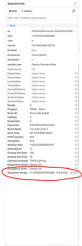

I am in the process of updating our scripts to incorporate these. For some of our workflows, we need to send hourly data associated with a room. With the old connectors this was done with list access, and you would end up with an array of 8760 values associated with a single property such as shown below:
I know you have now implemented nested properties which is great, however I can’t seem to find a way to send a list of values associated with a single property. Is this currently possible with the new connector?
Many thanks,
Dave
Hi David, currently we are not supporting list access in our properties, but this should be easy enough to add. I’ll make a ticket to include this in our stable release!
