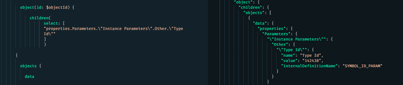

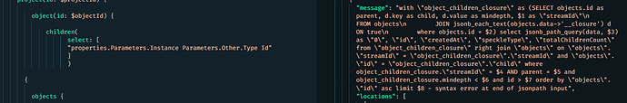

Trying to get “properties.Parameters.Instance Parameters.Other.Type Id”
This fails when dropped in as a single string:
But succeeds when additional /" stuff is added, but the resulting GraphQL gets a bit borked as a result
