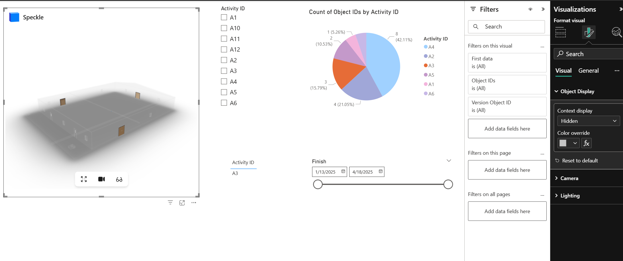

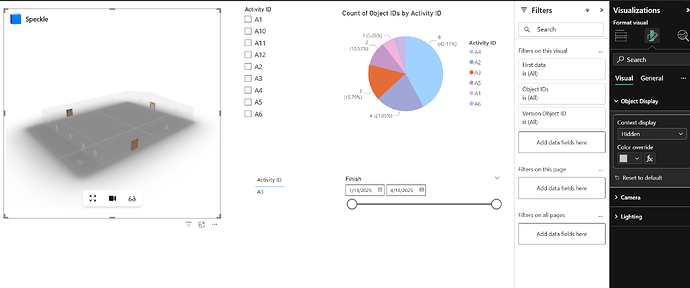

In Power BI Visual, there is an option regarding Object Display
This is Hidden option

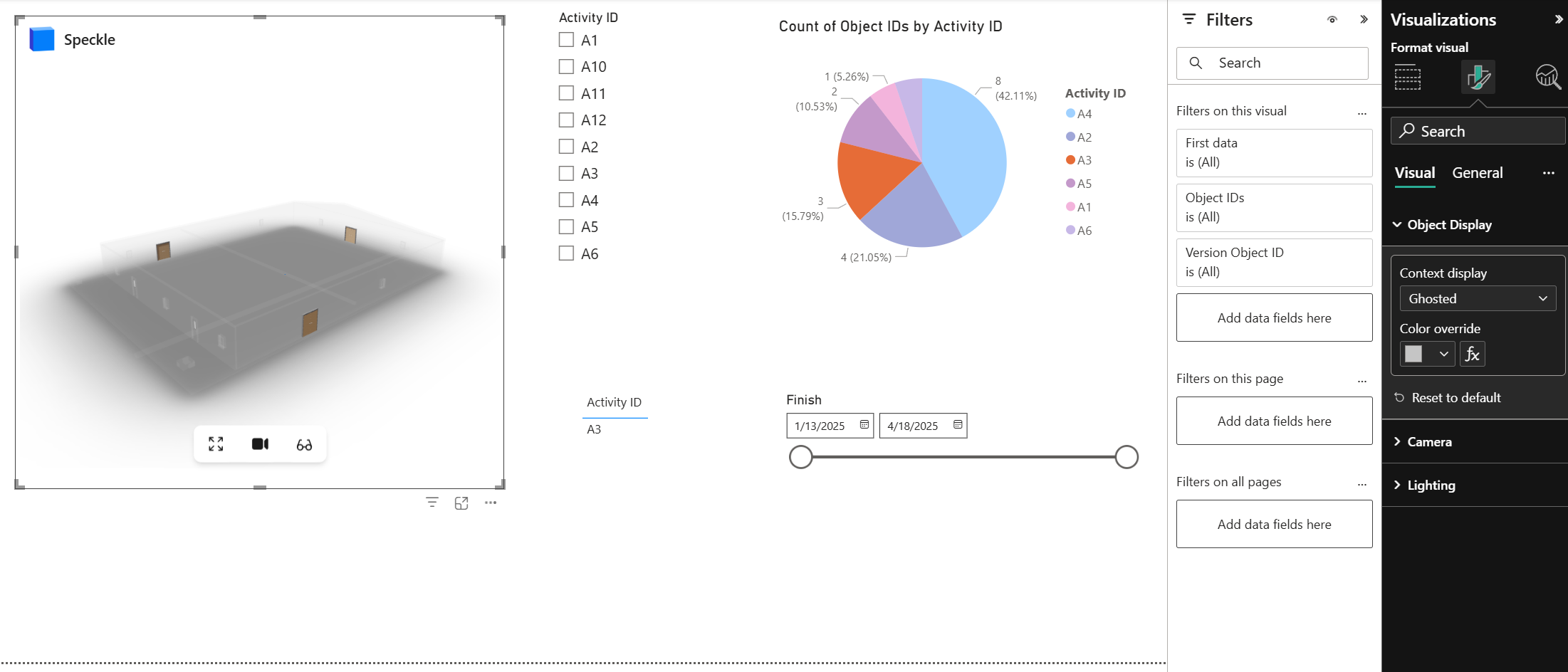

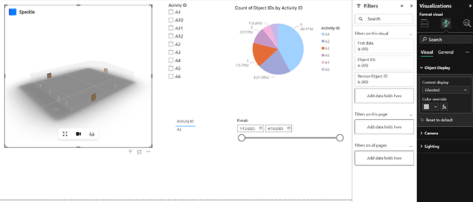

and this is Ghosted
I can’t see any difference there, could anyone help me ?
and this is Ghosted
Hey @Mohamed_Elmasri ,
This looks like a bug. Thanks for reporting it. We’ll add it to our backlog.

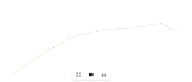

We have encountered a significant usability issue that presents a major barrier to using Speckle on infrastructure or large-scale projects.
As illustrated in the screenshot below, when attempting to locate and zoom in on a selected (sliced) element within a complex model hierarchy, the “Hidden” option is inactive. This makes it difficult to isolate or view specific components, especially in large 5D models with extensive geometry.
