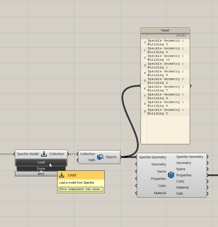

Hello Speckle Team,
When i pull data from Speckle Server, the order of the object is random everytime I loaded.
Ideally i wanted the same order of how the model is published.
Can someone look into it?

Thanks for the report @Ray_Yong , we have an issue open for this bug and will take a look this sprint
Hey! I’m experiencing the same bug. Is there a solution available?
Hey @Gonzalo_Munoz,
What version of the GH Connector do you have? This issue had been resolved. Try grabbing the latest version and giving that a go. Also, if it’s an old script, it’s a good idea to delete the components from the canvas and drop “fresh” ones after updating.
Let me know if that helps. If not, I’ll re-open the ticket.
