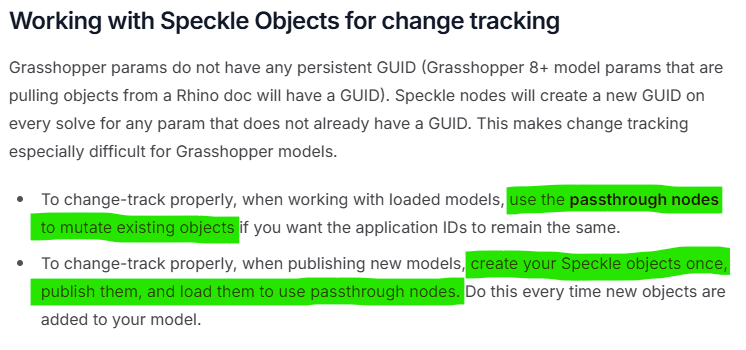

the docs cover some good ways to mutate existing objects to ensure a consistent applicationID is assigned to GH objects:
I have a few questions, ideas on this:

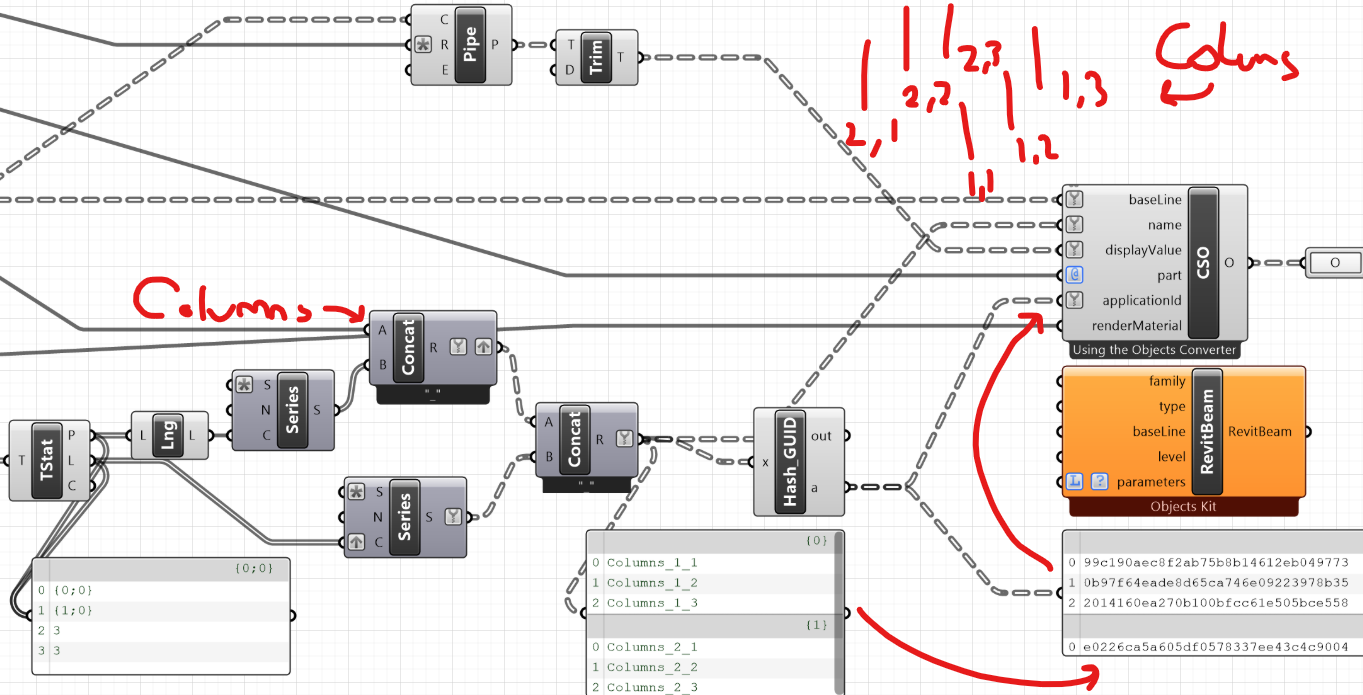

  1. in v2 i would often define the application ID from the logic within the scripts data structure, Hash of a unique_obj_type + path which would often be fairly consistent across iterations and where it isn’t probably not concerned about diffing?
  1. Loading the last published model in and using the passthrough nodes is a good approach. a few issues i see is that you still need a way to re associate the new geometry with the previous loaded, probably via a closest point match or something similar. depending on the changes this could be simple or not.
  2. There are likely scenarios where you want to take revit geometry and say split it into parts for analysis. This would create 3 new/ random application_ids for the new objects each time through GH. however there is a consistent logic to how these could be calculated if they could be set through GH. original_application_id + 1,2,3…

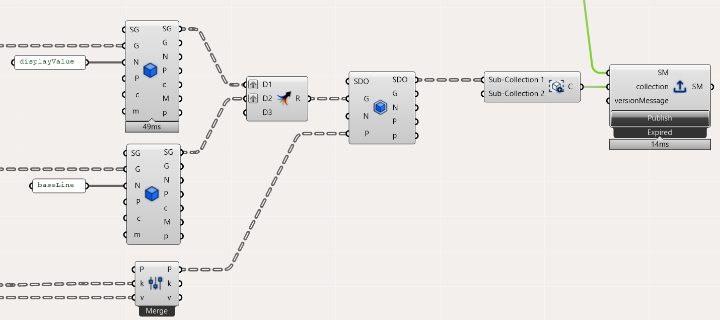

On the location data. I’m happy that we can create dataobjects constructed from multiple geometry (Brep and the base line geometry) to so they are both stored and accessible.
However there could well be times when you don’t really want the baseCurve etc rendered in the viewer but stored for future interoperability/ use but not presented.
Geometry can’t be added to properties so arn’t suitable.
