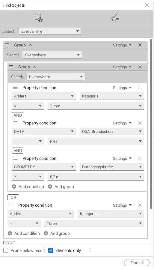

@jonathon I agree that when chaining filter criteria with different conditions the filter logic can become quite tricky very quickly. It’s probably also a challenge how to convey this logic to the user from u UI perspective. I think Revizto has solved this quite elegantly with filter groups:
Indeed, filter groups or something like it is what we’ve sketched, but speaking with many users… love them… this stretches the mind for some :smiley:
